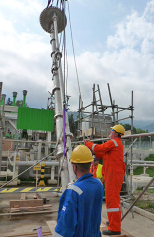

lifting pump into place

Amarinth reacted immediately drawing together a team of technical and mechanical people from its onshore and offshore skilled engineering staff. On arriving on-site they lifted the pump out but on strip down found that the damage was much worse than anticipated requiring a number of bespoke parts. These were ordered, manufactured in the UK and immediately shipped to Georgia. After fitting the parts and replacing the pump in the tank however, further issues were identified with the impeller, again requiring more parts to be sourced and shipped.
