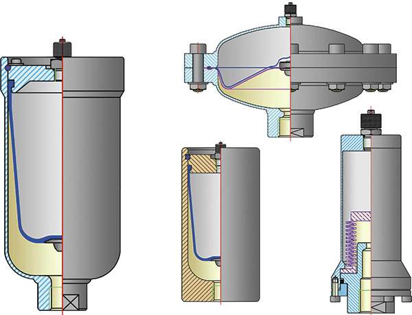

A pulsation dampener is a vessel with pressurized gas inside, normally nitrogen. The initial filling or inflating gas pressure inside the dampener must always be lower than the pressure of the circuit where it is installed. The inflating gas pressure of the dampener is designated P0.
In all pulsation dampeners, the bellows isolate the gas from the circuit liquid. The main function is to avoid gas leaks, which can be costly. This part that separates the two fluids is most frequently made of two kinds of material:
  • Rubber—The rubber may be nitrile, ethylene propylene diene monomer (EPDM), fluoroelastomers (FPM), butyl, silicone or a thermoplastic material, often polytetrafluoroethylene (PTFE). When rubber is used, the separator element is called a bladder. If PTFE is used, the dampener can be a membrane or bellows type according to the form of the separator element.
  • Stainless steel—Bellows can also be made of stainless steel. The use of one type of separator or another will generally depend on the particular characteristics of the circuit, such as the working pressure, temperature and the possible corrosive effect of the circuit liquid over the separator element.
Part One of this series covers the operation of pulsation dampeners. It also covers how to calculate the correct pulsation dampener size for an application.
Figure 1. Common pulsation dampener designs (Graphics courtesy of HIDRACAR)
