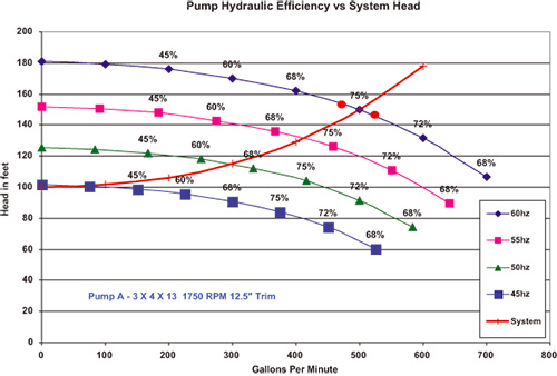

Let’s take a look at two lower flow pumps with different efficiency ranges. These are real pumps, and I downloaded the pump curves from the manufacturer’s electronic catalogs. Figure 1 shows the variable speed curves for a 3x4x13, end-suction pump (Pump A) operating against an ideal system curve that intersects the center of the BEP range at 60 hertz. The red dots show the BEP range. The BEP remains at 75 percent from approximately 465 gallons per minute (gpm) to 530 gpm (a 65-gpm range). At full speed, the efficiency drops to about 68 percent at 400 gpm.
Figure 1. The variable speed curves for a 3x4x13, end-suction pump (Pump A)
Under VFD control, the efficiency drops to about 71 percent at 400 gpm (approximately 54 hertz), and at 300 gpm (50 hertz), the efficiency drops to 65 percent. In a variable speed application, designed for flows from 250 to 500 gpm, pump efficiency will range from 60 percent to 75 percent. Figure 2 shows the performance curve for a 3x4x12, end-suction pump (Pump B) plotted against the same system curve. The BEP efficiency is also 75 percent, but the range is more than twice that of the example in Figure 1—425 gpm to 575 gpm (a 150-gpm range). Full speed efficiency drops just 2 points at 400 gpm and just 1 point when under VFD control. At 300 gpm, variable speed efficiency remains at 71 percent. In a variable speed application designed for the same range of flow as the example in Figure 1 (250 to 500 gpm), Pump B’s efficiency ranges from 68 percent to 75 percent.
