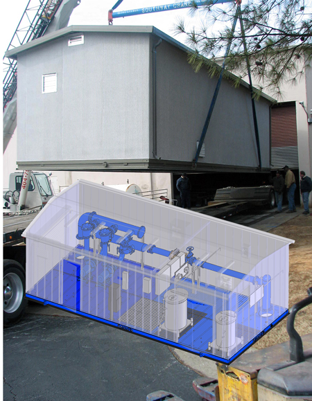

The Enclosure
The system enclosure (building) was manufactured to the requirements of the state to which it was destined and carried that state's required label. This enclosure was mounted on the pumping and treatment skid, and the entire product was delivered to the site as a single unit.
This enclosure is a self-framing metal building with a standing seam metal gable roof. The exterior façade is Fullerton Finish Systems WalStone siding. Three doors are supplied, one double door for the chemical room, one double door for the pump room and one roll up door for pump room service.
The interior finish is white pebble textured fiberglass reinforced plastic (FRP) over plywood, which covered R-21 insulation. A sealed internal partition separates the pump room from the chemical room. Floor drains are provided in each room, as well as ground fault interrupting receptacles, fluorescent lighting, emergency lights, smoke alarms and door switches for intruder alarms. There is an HVAC unit in the pump room and a heater and ventilation in the chemical room.

Shipment and Delivery
For shipment, the loose items were protected and then strapped down to prevent damage to themselves or other equipment within the chemical room. Once the equipment arrived on site, the contractor off loaded the equipment, set it in place, connected the inlet and outlet piping, installed the automatic transfer switch and RTU, connected power and called the manufacturer for a start-up technician to start the system and place it in operation. Chemicals for use in the chemical room were supplied on site by others.
As a result, the engineer and customer received a fully functional pumping and treatment system integrated into a single package, needing only piping, power, RTU connections and the addition of chemical to the storage tanks.
