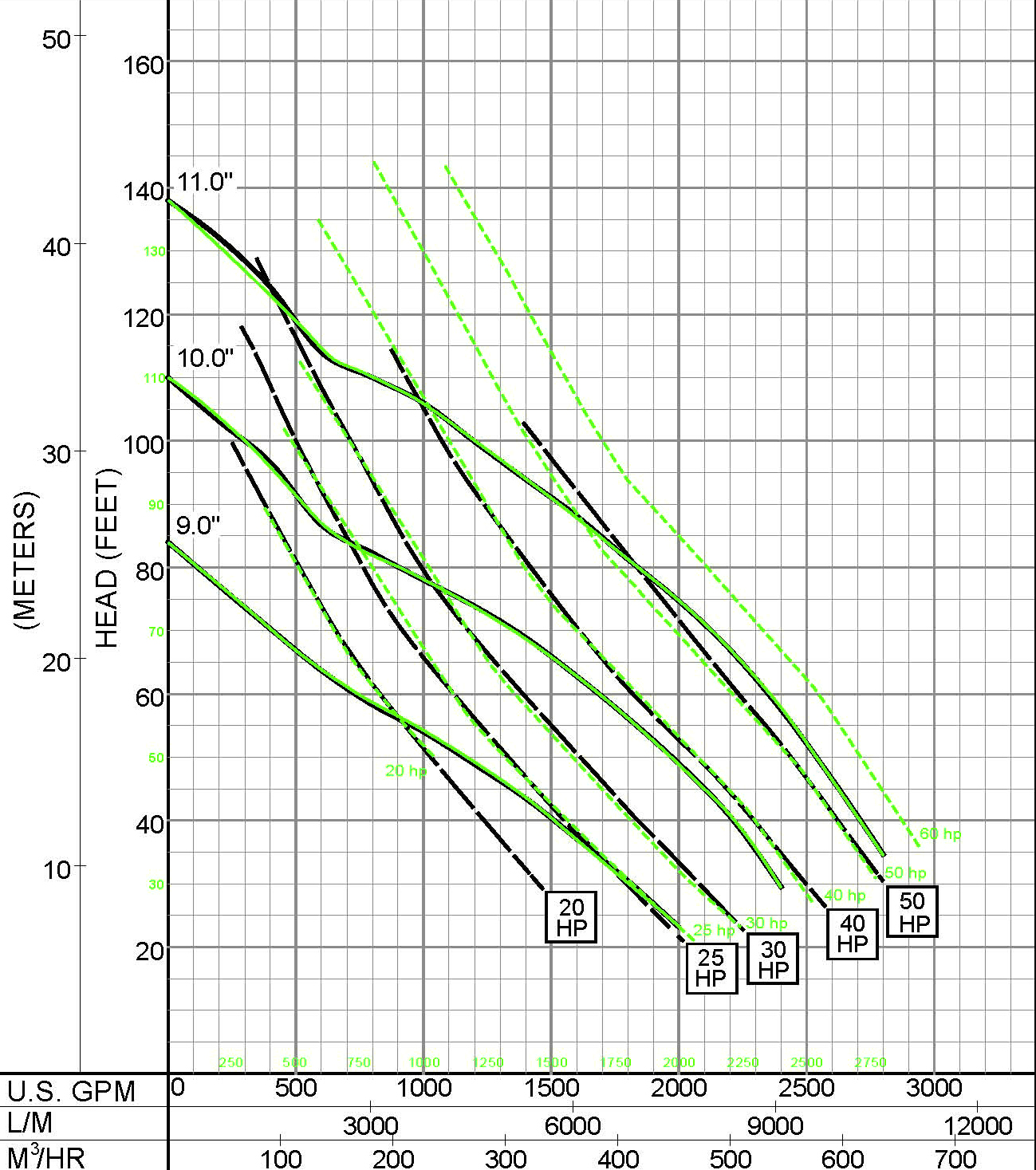

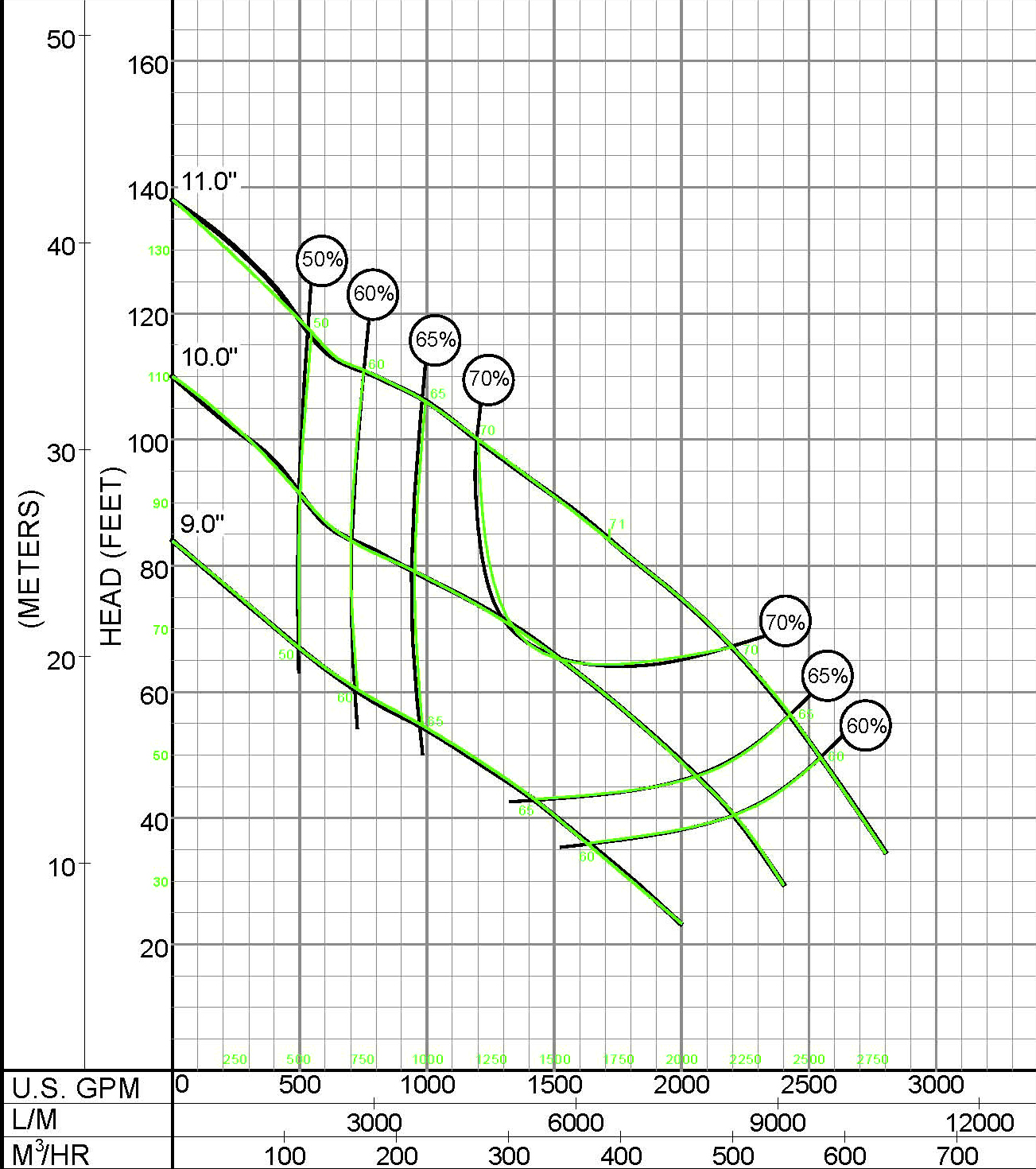

figure 5a figure 5b
Figure 5a. Performance and efficiency curves from cubic spline regression analysis. Figure 5b. Performance and power curves from cubic spline regression analysis.
Now consider the curves in Figures 5a and 5b. In this case, the pump selection software properly digitized the efficiency curves from the manufacturer using a cubic spline regression analysis. The isometric efficiency curves are dead accurate at every point in the graph, and the efficiency is never overstated. In figure 5b, the power curves also track extremely well with the manufacturer's, given that they are calculated power curves, and more importantly, the endpoints at the run out flow rates are accurate.
