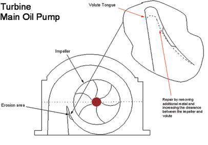

The control rotor in question was the turbine/generator oil pump shaft being driven on the end of the turbine/generator shaft. The oil pump impeller had six vanes, and it was discovered that the pump casing had been welded and repaired during the outage due to erosion damage on the visible side of the volute tongue.
A primary source for high vane pass vibration in a pump would be a tight or insufficient Gap B. Gap B refers to the distance between the impeller vane exit and the diffuser/volute vane inlet and is normally expressed as the percent of the impeller's diameter. A tight Gap B results in shock waves or pressure pulses that are generated each time an impeller vane passes the volute tongue. These shock waves can cause cavitation/erosion damage typical of the ones weld-repaired during the outage.
The shock waves and pressure pulsations can be so great that the volute tongue and/or shafts can fail in fatigue, the impeller-side plates can break, or the pump flow control systems may become unstable. A typical Gap B ranges from 6 to 8 percent in volute-style pumps, and many installations require 12 to 15 percent to reduce the vane pass vibration amplitudes to acceptable levels.
The case and impeller were measured, and the measurements revealed that the Unit 4 oil pump Gap B was only 3.5 percent. Unit 4's Gap B was opened to 8.5 percent, and the vibration dropped from 1.6 inches per second to 0.43 inches per second.
After final opening, Unit 4's Gap B was 12 percent with resultant vibration amplitudes of less than 0.14 inches per second. All the oil pumps on the four units were modified by the end of 2001. Since that date, no forced outages have occurred due to a false overspeed governor trip during normal operation, and none of the overspeed trip devices have required replacement.
| Figure 2. Clearance for the impeller was improved by removing additional metal. |
As the pump cases on each unit were examined and modified, it was apparent that the equipment manufacturer for the pump case placed no control on the final configuration of the volute vane. The configurations were not the same in any of the cases. Several of the cases had the volute vanes cut to a diameter but no finished to provide a proper and consistent profile.
