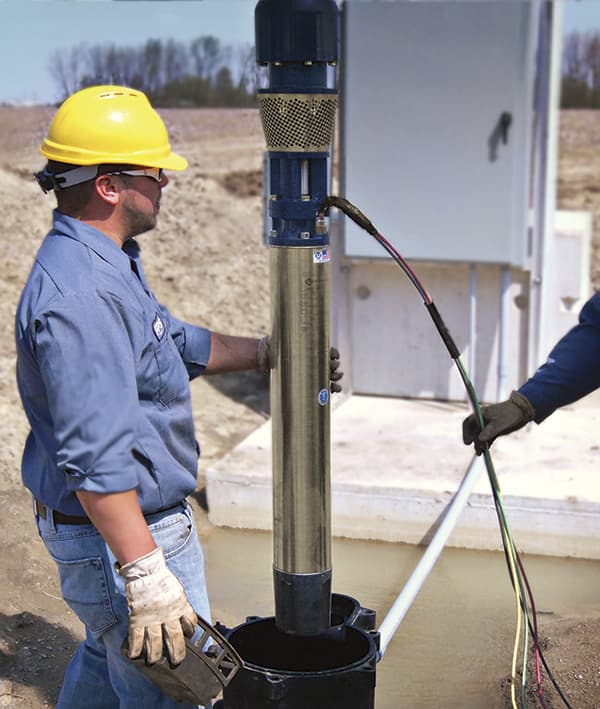

Image 2. The submersible motor shown here may actually be a more efficient option than a surface motor, depending on the pump and drive/control it is paired with.
