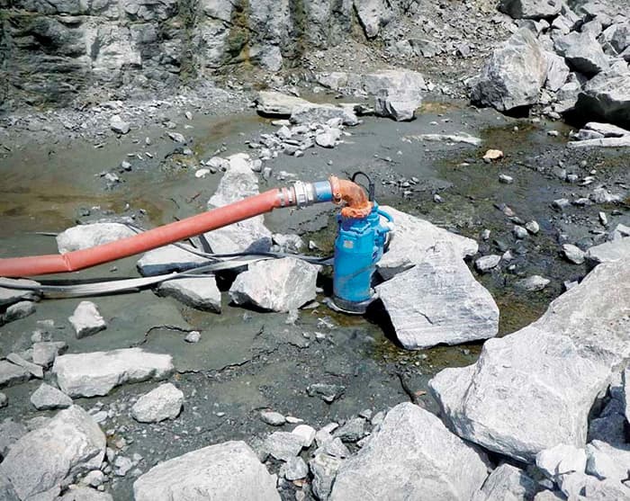

No industry puts its pumps through the ringer quite like mining. When the price of commodities such as gold spike in the short term, there is no time to lose—companies have to act fast to extract whatever they can as quickly as possible. While this flurry of activity is great for stockholders, it is not ideal for equipment. Many pumps end up falling prey to a myriad of problems that range from corrosion to being crushed by heavier machinery. To protect mine dewatering pumps to the fullest extent, consider these six common threats that pumps may encounter during mining operations.

1. Suspended Solids
The most prevalent cause of mine dewatering pump failure is clogging from gritty, suspended solids and slurry. Water that makes direct contact with the operation is often dirty, containing foreign materials such as drill cuttings or solids generated by underground ramp traffic. When combined with the clean water that is removed from an aquifer, the result is a slimy texture that can clog pumps. The key to overcoming this challenge is proper sump design. Clean water should be collected at the source, while abrasive solids-laden water should be separated into an isolated area within the sump.2. Corrosion

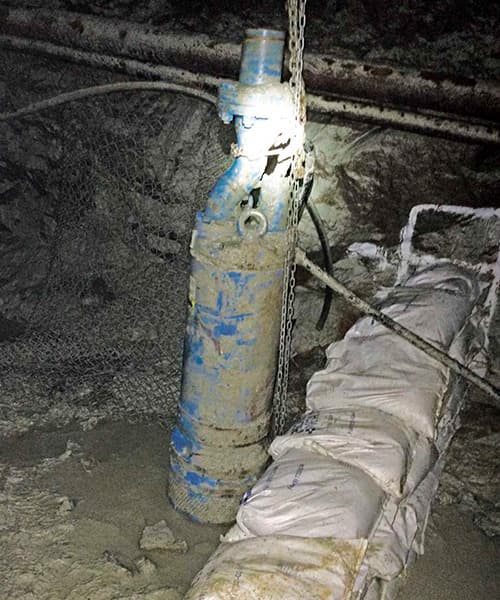

The fluids in mining applications are among the most volatile a pump can move. From superheated water laden with pyrite, iron or sand, to emulsified brine phase drilling fluid, there is no shortage of liquids that will punish a pump over time. If a pump is constructed using solid metallurgy, the corrosion process can be slowed to a degree. Stainless steel pumps are preferred in these applications, including one new series of submersible dewatering pumps that are manufactured using SCS14, a cast equivalent of 316 stainless steel. Even the hardiest equipment can succumb to corrosion, so it is important to make use of sacrificial anodes to increase the life of cathodic protection. An anode made of metal with a lower electrode potential—such as magnesium, zinc or aluminum—will take the brunt of corrosion during the pump’s application, protecting the metal that composes the pump. These protection plates must be monitored and replaced before they corrode completely..jpg)
