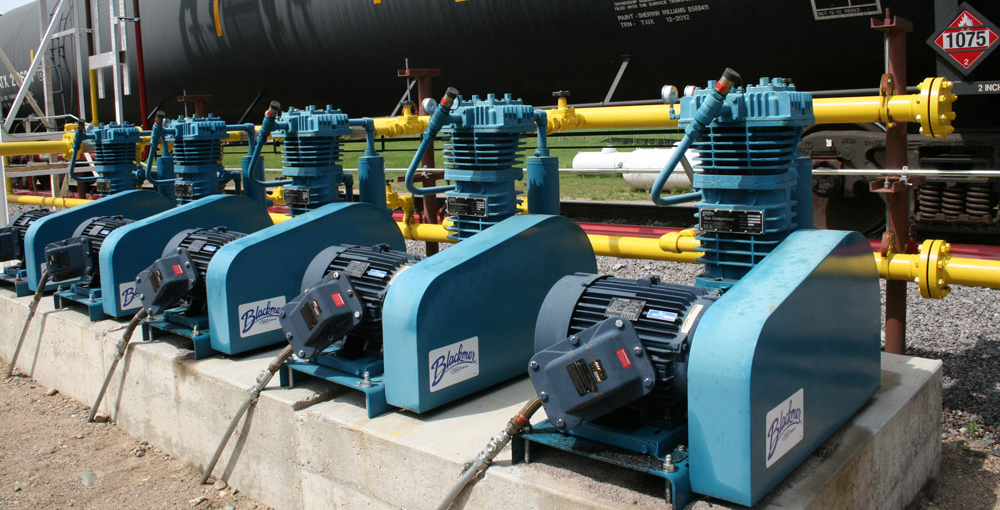

No self-respecting chef would attempt to make a new recipe without first having a list of ingredients. Anyone who is trying to piece together a jigsaw puzzle would like to know what the finished product is supposed to look like. The same logic can be used for industrial manufacturers: no one should acquire a compressor without first knowing all of the operational parameters of the application.
This article will discuss in general terms the transfer of all types of commodities in industrial applications via a reciprocating piston compressor.
