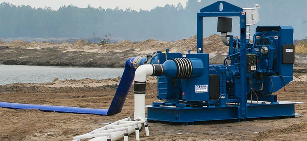

dewatering united rentals
IMAGE 1: Current and future jobsite conditions must be considered when choosing a dewatering method. (Image courtesy of United Rentals)
Planning for All Possibilities
Choosing the right dewatering method requires considering the current conditions as well as possible future conditions. The soil types, excavation depth and buildings and infrastructure surrounding the site can influence a project. Taking a detailed soil boring to understand the soil components and the strata (including where the permeable layers are and the depth and formation of each layer) and performing a pump test are critical to determining the best method.
