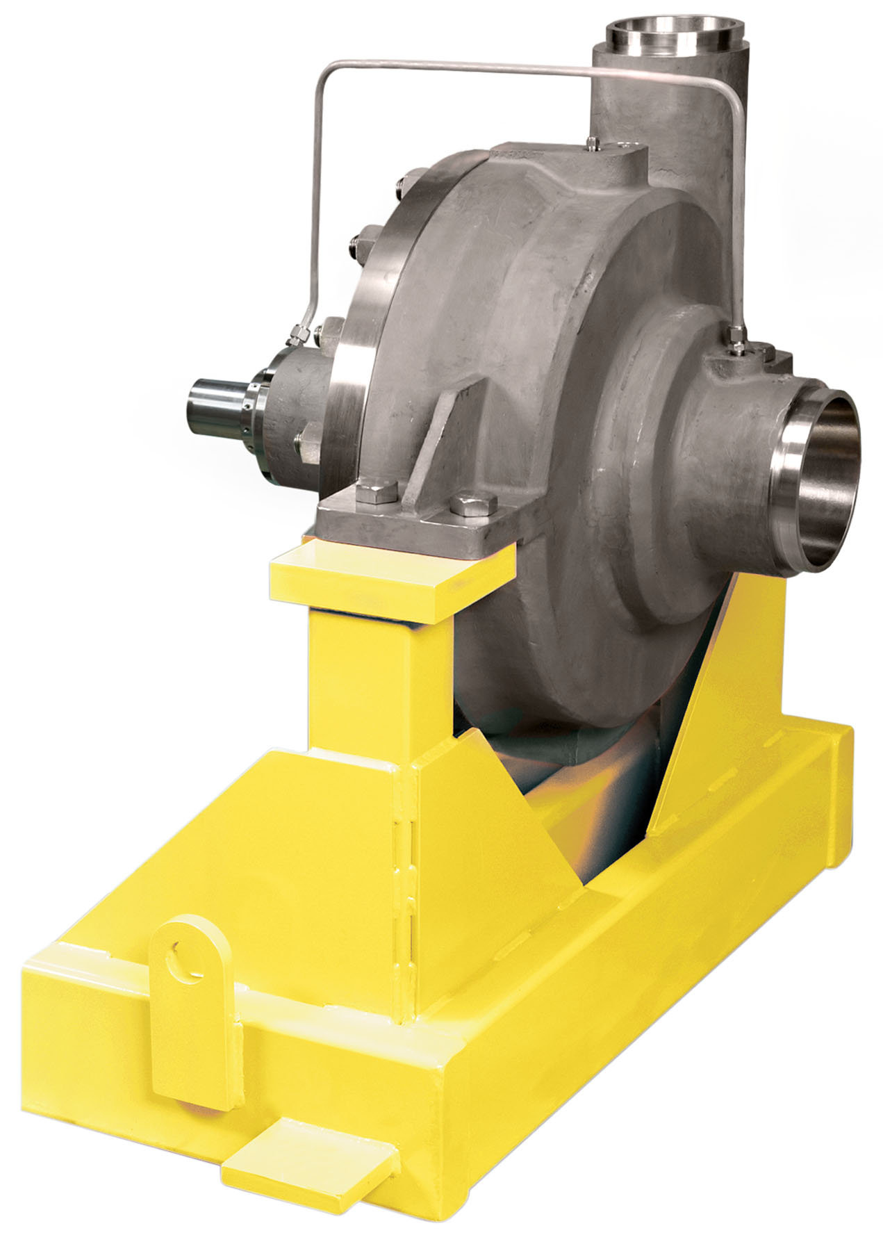

One pump model, a variable speed single-stage pump specifically designed for seawater desalination, has a design point at a capacity of 5,700 gpm at a total developed head of 1,107 feet at 3,600 rpm. Solid polymer bearing technology allowed operation at high loads and very thin films, reducing thrust bearing power losses that can dramatically impact the pump's overall efficiency. Throughout the development process, the pump achieved efficiencies in the mid to high 80s. Efficiency levels approaching 90 percent are anticipated as the product line is expanded. The high load carrying capability of the bearing solution eliminated the need for a thrust balancing system (traditionally an industry standard), reducing design complexity and areas of maintenance and potential failure.

| High efficiency advanced variable speed single-stage pumps specifically designed for SWRO high-pressure service. |
