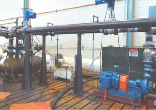

(Left) identical AFW pump (Right) booster pump
Configuring the Test Lab
Once the scope had been clearly defined and agreed upon, the test lab engineers set out to configure the lab in a way that would duplicate, almost identically, the plant's AFW suction piping set-up.
Within 10 days, the test lab was configured with a booster pump installed with a variable frequency drive to simulate the SX system as closely as possible so that the safety-related AFW pump could be operated within the same environment as it would function in the plant. The SX water source came from the test lab's 38,000 gallon suppression tank that was fed through the booster pump. The CST, which was simulated by the test lab's suppression tank, was not sent through the booster pump.
