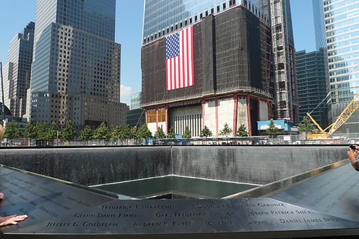

To commemorate those who died at New York City’s World Trade Center on September 11, 2001, a memorial entitled “Reflecting Absence,” was erected. The site consists of a 16-acre plaza with 400 trees that surround two recessed reflecting pools. Each pool is close to an acre, and they are in the footprints of the Twin Towers. Both reflecting pools hold 600,000 gallons of water, and they are the largest man-made waterfalls and reflecting pools in the world.
Waterfall Challenges
The contractor chosen by the architects, Delta Fountains, faced a series of challenges from the start. The reflecting pools required massive plumbing, pumps, filters, water chemistry tanks and precision automation controls to keep everything operating smoothly 24/7 throughout New York City’s four seasons. The memorial challenged the contractor’s engineers to design a method to keep the water in the fountains flowing in clear streams from a 29-foot fall, while maintaining the required reflective and acoustic properties year-round, no matter the weather (see Image 1)..jpg)
