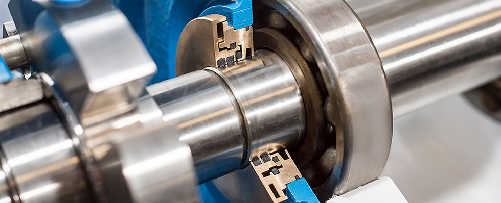

A bearing isolator in use (image courtesy of SEPCO)

A common type of bearing isolator used to protect bearing lubrication is the contacting, compound labyrinth bearing isolator with a dynamic O-ring. Most other isolators are a derivative of this original design. The O-ring expands under dynamic conditions, which allows the housing to vent through the seals. Once the machine shuts down, the O-ring then contracts. This development was beneficial in advancing rotating equipment and is able to keep contaminants out by directing them outside the seal.
Contact-bearing isolators have their limitations. They struggle in environments with heavy contaminants, such as sand, dust and other debris, and settings with steam or oil mist. Because they typically contact the lip seal within the housing, they also cause the seal to wear down, and they cannot block contaminants during machine shutdown. Noncontact, compound labyrinth isolators are similar in design to the contact version but function differently.
Noncontact-bearing isolators use specific clearances, gap changes and direction changes to direct contaminants away from the bearing through gravity and centrifugal force. Because they do not contact a lip seal to operate, there is less wear on the seal and the bearing within. Noncontact-bearing isolators also struggle under static conditions.
As the machine shuts down, the bearing housing draws in air from the environment to reach a state of equilibrium, which can also draw in contaminants from the environment. Vertically oriented, noncontact isolators use their design of specific gaps and chambers to break down these contaminants’ energy and eventually force them away from the housing while still allowing in air that will not damage the lubrication. In other words, these isolators will enable the housing to breathe while controlling precisely what the housing inhales through the laws of energy conservation and gravity.
