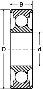

Jerry was right, too. Bearing manufacturers do have tricks up their sleeves, but they are often very helpful ones. For example, the MRC catalog in this situation lists bearing dimensions (abridged) as follows in Table 1:
Table 1.
The 309S bearing inside Jim’s pump follows an accepted ABMA standard for clearances and interferences between shafts, housings and bearing ID and OD. The rule for a shaft-bearing fit is set not by the shaft, but by the bearing, and then the shaft diameter must follow.
In Table 1, shaft dimensions must be (as shown) between 1.7722-in and 1.7718-in, which creates an interference ranging, depending on the tolerance, between 1.7718 – 1.7717 = 0.0001-in and 1.7722 – 1.7717 = 0.0005-in, i.e. a light interference fit.

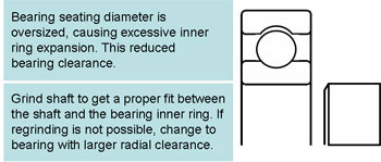

“If this problem was the other way around, with the shaft being too big, then it would probably not fit-in well at all,” he added. “This means you would likely wreck the bearing when trying to press it on, or ruin it quickly in operation because it would be highly overstressed. This, in turn, would cause it to run hot and probably fail in no time. So consider the bright side – there is a silver lining!”
The opposite of a ‘bright side scenario’ that Jerry described is actually anticipated by bearing manufacturers. If you read their publications, you may learn something useful. SKF, for example, states this in their instruction manuals:
This is an example of a situation that is the opposite to what Jim experienced – but still a big problem.
