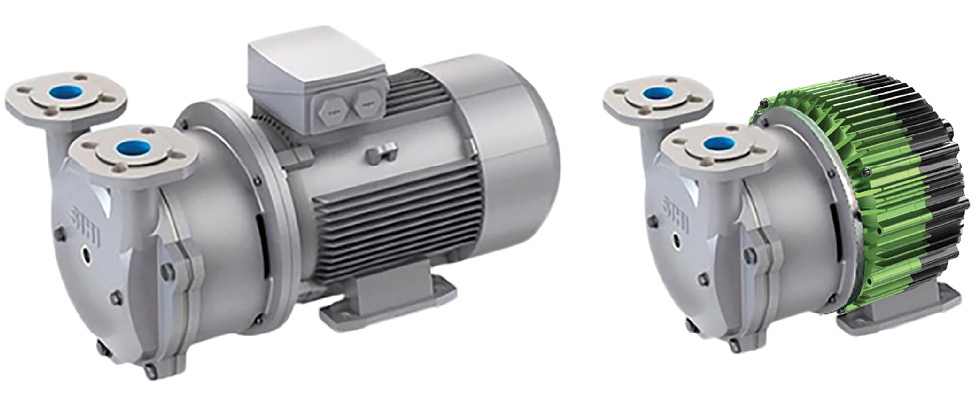

IMAGE 1: (left) Pump system with a traditional induction motor; (right) pump system with an EC motor (Images courtesy of Conifer)
Firstly, and probably most importantly, there is the sticker shock of seeing the upfront price of an EC motor. While it is true that an “equivalent” EC motor can cost upward of 50% more than an induction motor, this increase in capital expenditure (capex) is often substantially or completely offset by the savings in operating expense (opex). Not only would an EC motor be more efficient in general and therefore reduce energy costs, but optimizing a motors control strategy around a specific duty cycle could unlock even more savings.
Furthermore, if precise speed control is required, motors with an integrated drive can reduce the bill of materials (BOM) and maintenance costs of an auxiliary variable frequency drive (VFD). EC motors themselves also offer high reliability, further lowering general maintenance costs. A widely accepted engineering principle states that for every 18 F (10 C) increase in winding temperature, the thermal life of the motor’s insulation system is reduced by half. Any applications that require service factors greater than 1.0 can see great benefit from switching to EC motors, which can operate much cooler.
Finally, the cost of the materials and electronic components in an EC motor is shrinking. Advances in motor topology and material science are still pushing the cost of EC motors down, while traditional induction motors have mostly levelized, so the situation is trending in EC motors’ favor. When accounting for all these hidden costs, the true lifetime cost of an EC motor is substantially lower than that of an induction motor.
The next likely concern is around the complexity of EC motors, particularly around the integrated electronics that give the motors their flexibility. These electronics enable advanced control strategies, but if they fail, repairs can be more specialized and costly compared to mechanical failures in traditional motors. With advances in power electronics and control systems, however, this failure mode is much less likely than a bearing or winding failure in the motor. A well-designed EC drive is often designed to last longer than the motor itself. In the case of an unexpected failure or external damage to the electronics, many EC motors can operate with standard, off-the-shelf PMSM-compatible VFDs.
Some suppliers are concerned with the integration challenges associated with switching to EC motors, believing they are not available in standard National Electrical Manufacturers Association (NEMA) frame sizes. This is no longer the case either. Contemporary EC motors are often fully compatible with NEMA frame sizes and mounting dimensions, eliminating costly redesigns and integration headaches.

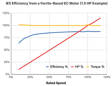

IMAGE 2: Chart showing IE5 efficiency from a ferrite-based EC motor
Finally, users are often concerned about supply chain risks around EC motors—particularly the continuing trade tensions surrounding rare-earth magnets. In April 2024, China, the supplier of around 90% of the world’s rare-earth elements, imposed severe export restrictions on rare-earth magnets. This geopolitical move has disrupted global supply and raised costs, renewing concerns for industries reliant on these materials.
In response, many EC motor manufacturers have started to shift focus to ferrite magnets, which are both 90% cheaper and globally abundant. While ferrite magnets are weaker than neodymium magnets, new motor topologies have enabled EC motors using ferrites to achieve IE5 “ultra-premium” efficiency ratings, while still being more compact than equivalent induction motors.

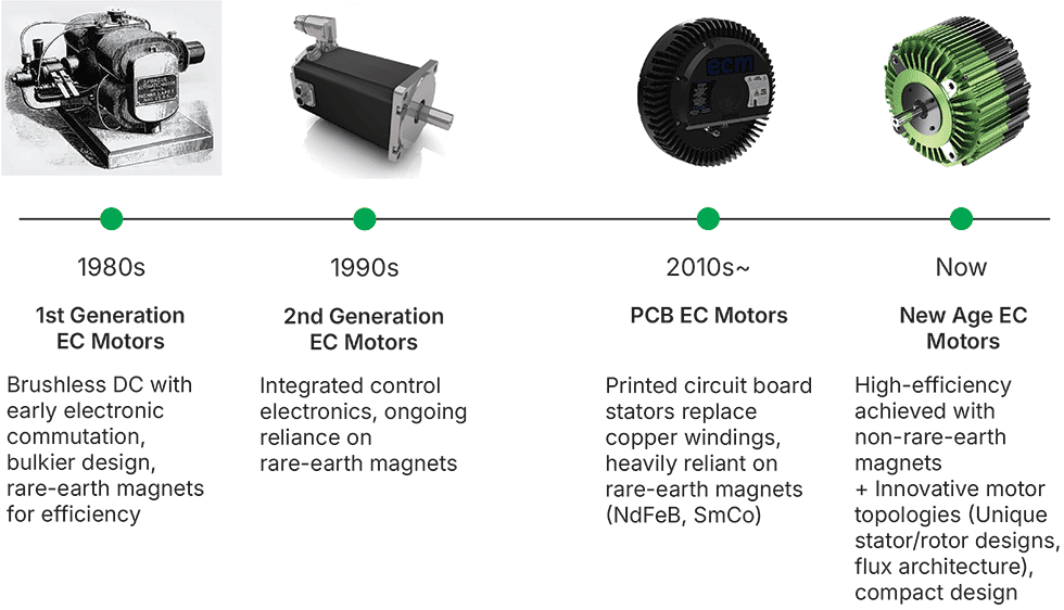

IMAGE 3: The evolution of EC motors
Perhaps anticipating this demand, more and more manufacturers have recently entered or emerged in the EC motor space. This has led to more innovation in the form of even more efficient, more compact and more reliable designs. For example, in the late 2010s, the industry saw the emergence of printed circuit board (PCB)-based EC motors, and just in the past two years, newer technologies with ferrite magnets have entered the scene. This increasingly competitive market space will drive the price of EC motors down further, reducing the barrier of entry for users.
