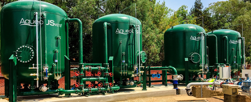

Case study #2: California well water treatment system designed for state’s largest water supplier
In 2017, a well site in Rancho Cordova, California, was developed in tandem with a local contractor and national engineer to construct a 1.4 million gallon per day (mgd) GAC well water treatment system to remove perfluorooctanoic acid (PFOA) and perfluorooctanesulfonic acid (PFOS), which were detected in the local supply at 180-200 parts per trillion (ppt) combined. As the site was located in a suburban area, a solution was sought that would achieve public expectations for aesthetics and minimal visibility.
The resulting design included two 475 gpm two-vessel systems that could be used in either parallel or lead-lag configuration to achieve target levels of PFAS. The overall system height to the top of the pipe was 15 feet and 10 inches, and, as an added touch, a shade of forest green paint was utilized that would allow the structure to blend in with the natural surroundings.
