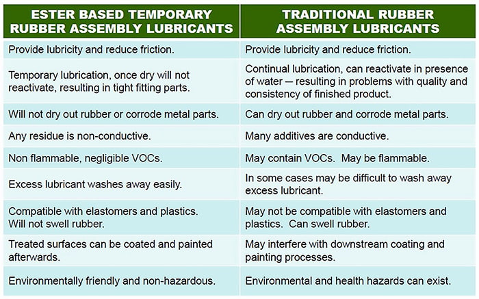

Table 1. Lubricant comparison chartTemporary Rubber Assembly Lubricant Capabilities
Reduce installation force. A thin film of lubricant allows rubber surfaces to slide across each other. By reducing the surface tension between two surfaces, lubricants help rubber parts slide easily into place. The lubricant disappears once dry, resulting in a tight fitting assembly. Achieve closer fits. Engineers can design lower tolerance parts. The force needed to install the parts when a lubricant is used is greatly reduced. Since the lubrication is only temporary, once dry, the parts stay in place resulting in a tight fit. Improve product performance. Improper part alignment can lead to part failure and safety issues. Using a rubber assembly lubricant, which enables the parts to slide easily into place, can solve these problems by reducing or eliminating damage to parts. Increase production rates. Applying an assembly lubricant to the rubber part makes the rubber slippery, so parts can easily slide into place. After the lubricant dries, the lubricity goes away, and mated parts maintain a tight fit. The assembly process becomes more productive. Help prevent worker injuries. Lubricants reduce the insertion force needed for rubber assembly. Workers can more easily push parts into place, reducing the amount of musculoskeletal, slippage and repetitive stress related injuries that can be caused by using too much force to insert a rubber part. There are many types of lubricants available, so how does a plant manager choose the right one for the job? It’s important to consider the performance and safety of each to make the right choice. Types of lubricants include:- Solvents. These offer poor lubrication (as compared to other choices). More importantly, these substances may be flammable and pose various safety risks. They may also dry out the rubber parts.
- Soaps and detergents. These offer nominal lubricity but can reactivate later on when wet, causing parts to move when they need to remain stationary.
- Petroleum distillates. These are often not compatible with rubber parts because the lubricants can cause the parts to swell. The lubrication is not temporary.
- Specially formulated ester-based products. These offer temporary lubrication, providing excellent reduction in friction. These lubricants are safe for the environment, the parts and the workers.
