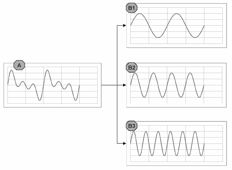

Figure 2. Complex dynamic waveform decomposed into sine wave components. A is the complex wave to be processed. B1, B2 and B3 are the fundamental sine wave components of the original complex wave.

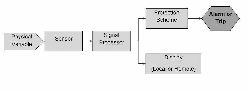

Predictive maintenance methods depend heavily on monitoring systems that can accurately sense and report one or more key equipment condition indicators. Most monitoring systems have several distinct components (see Figure 1). The monitoring system’s intent is to take a physical event and convey that change so it can be observed over time. A decision can then be made about the proper action to take.
All monitoring systems have sensors that detect and transmit signals, usually a current or voltage, to the signal processor. Next, a signal processor receives the signal and converts it to a usable output signal. Signal processing may filter unwanted portions of the input signal, convert signals to digital sets of values or calculate average, maximum or minimum values of a series of inputs. The design of signal processors are numerous and varied in purpose. Ultimately, an end user needs the signal processor output to provide a useful output that can be displayed or used in a protection system or scheme.

Static signals do not carry any rapidly changing, or dynamic, components. Dynamic signals, however, can vary rapidly with time (see Figure 2). Also called dynamic waveforms, they require more complex signal processing to determine their properties. Processing speed is critical when high speeds or high frequencies are involved. Typical waveform properties are frequency, peak amplitude, root mean square amplitude and phase. In some cases, both static and dynamic information are extracted from the raw sensor data.

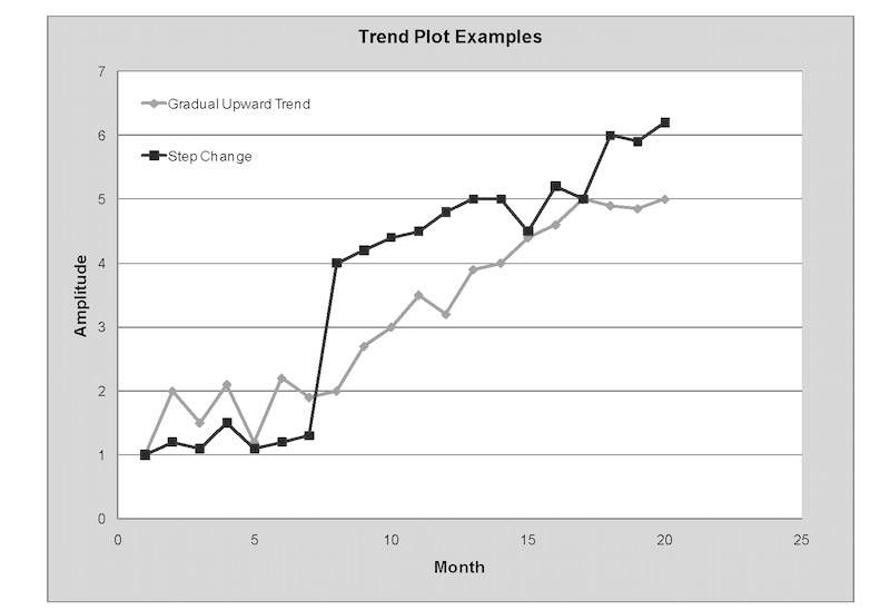

Figure 4 illustrates two trend plots. One shows a gradually increasing value, the other step changes in a measured value. Trend plots provide visual representations of the measured parameter over time, helping troubleshoot. Suppose a step change occurred at the same time as a change in the process. A correlation between the two events should be investigated. Gradually increasing trend plots may indicate deteriorating internal or external components.
