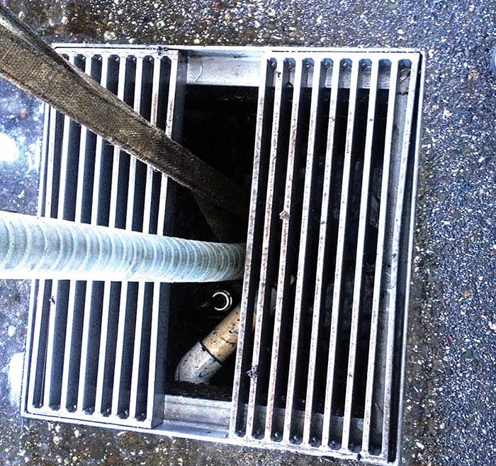

In this challenging environment, the combination of caustic cleaning fluid, high temperature and high head was causing the original cast-iron pumps to fail.
"The pumps that were originally specked out weren't able to handle what they were exposed to," Jennings said. "If the pump fails, we don't have very much storage space for recovered fluid." As a result, the maintenance crew would have to bring in a separate unit to pump it out.

Image 2. One of two pumps installed at the California Olive Ranch sits in this sump in the plant floor collecting drainage from the 30,000-square-foot tank farm and production facility.Image 2. One of two pumps installed at the California Olive Ranch sits in this sump in the plant floor collecting drainage from the 30,000-square-foot tank farm and production facility.

The original pumps were pedestal pumps that sat on top of a column. The columns extended into the water so the pumps' motors weren't subjected to chemicals or heat. Because the arrangement had a long, extended shaft with a sleeve bearing, however, the pumps did not last long.
To help COR solve these pumping challenges, Peters recommended high-temperature, high-head, 316 cast stainless steel pumps in the COR sumps. These stainless steel pumps could withstand caustic cleaning solutions, temperatures up to 200 F and up to 90 feet of head.
These side discharge submersible dewatering pumps were designed for harsh conditions and are typically used in sump applications where the liquid level can be controlled and where the pumps are partially submerged.
The pumps have several features that enable them to withstand the harsh conditions at the COR facilities. For example, all metal parts exposed to pumped liquids are made of 316 stainless steel, and elastomers (gaskets and O-rings) are made of FKM. In addition, the motor is protected by double mechanical seals. The lower seal is made of silicon carbide/silicon carbide, and the upper seal is made of carbon/ceramic. An additional lip seal is installed above the impeller to help prevent abrasives such as dirt, silt or sand from entering into the seal chamber. Winding protection and National Electrical Manufacturers Association (NEMA) Class R motor insulation with a thermal cutout switch allows the stator to have a winding temperature of up to 300 F (150 C).
"We really haven't had any real issues since these pumps have been in," Jennings said.
