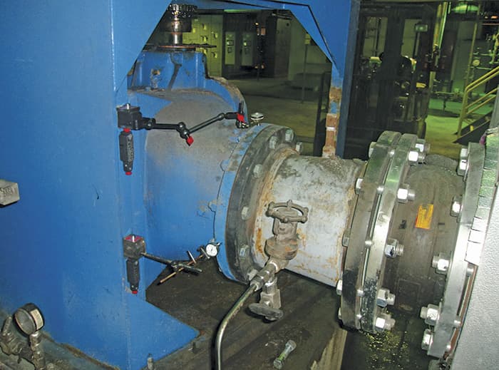

The effect of the alignment and nozzle loads, as well as seal assembly detail, was to be evaluated next during the removal of a pump at the next outage. This article describes some findings of the pump removal and disassembly inspection.
.jpg)
- No radial runout issues on the shaft (before removing the rotor from the casing). Checked at the coupling end, between drive end (DE) bearing and seal and between non-drive end (NDE) bearing and seal.
- Axial end play of the shaft was essentially zero.
- No significant impeller runout.
- Minor wear of wear rings, with diametral clearance about 0.010 inches.
- Both sides of the impeller had some cavitation damage (after about seven years in service), although the NDE side had significantly more damage than the DE, indicating possible non-uniform suction piping flow.
