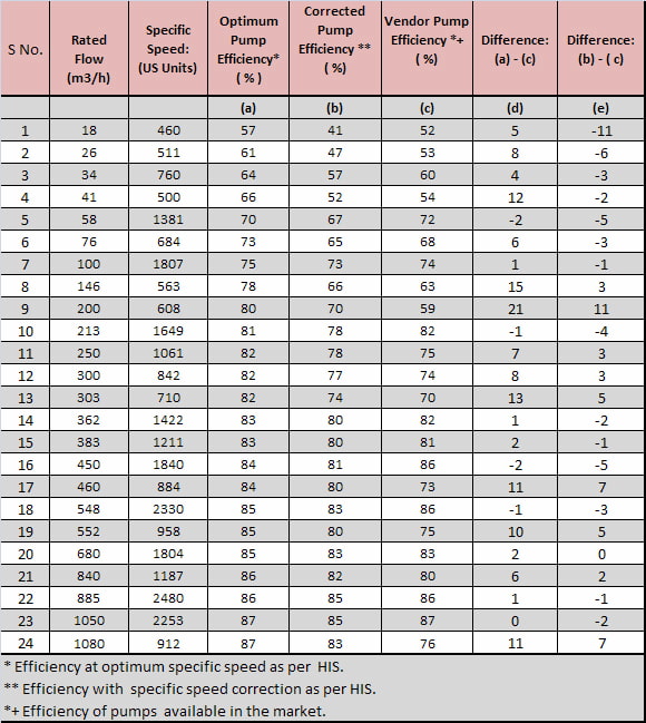

Based on the charts from Figure 1A, an interactive Excel spreadsheet was developed to help make the efficiency calculations faster. To check the reliability of the charts, the efficiency values calculated using them were compared with the pumps available in the market. This comparison, shown in Table 1, was carried out for most of the widely used pumps: API overhung center-line supported (OH2 Type) pumps designed as per API [7] in capacities ranging from 18 cubic meters per hour (m3/h) to 1,080 m3/h. The figures in Columns D and E in Table 1 reveal that reliability of the prediction is higher if the pumps’ specific speeds are closer to 2,500 rpm.
Higher efficiencies are observed when the specific speed is near 2,500 rpm. This suggests that pump users should try to purchase pumps that have specific speeds close to the optimum specific speed of 2,500 rpm. Pump users can achieve this to some extent by selecting the right combination of speed, head/stage and type as indicated in Table 2. However, in actual applications, selecting a pump using these criteria is not always practical. In such cases, the pump user can use HI’s predicted efficiency values at optimum specific speed, as well as with specific speed corrections. This will give a reasonable understanding of efficiency for pump selection. These values provide a possible range of efficiency and power savings for making an informed decision.

Considering the limitations, an energy audit was conducted on the pumps in an operating refinery. Some of the audited pumps’ data are shown in Table 2. The efficiencies of the pumps (those predicted with the HI method for different design options and those per other approved vendors are mentioned. The possible energy savings are also noted. The power consumption details will facilitate life-cycle cost studies to decide about the replacement or upgrading of existing pumps.
The column “Comments” provides possible actions. The interacting spreadsheet can be used to generate options (Table 2) to make more informed choices. These options (for example, Case 1) show the possibility of using cheaper, overhung pumps with almost the same efficiency (60 percent) or between bearing pumps with more stages with considerably higher efficiency (68 percent) for existing between bearing pumps. The market availability of pumps with efficiencies close to or better than what is predicted by spreadsheet proves the practical application of the spreadsheet. Most important, the spreadsheet indicates the possibility of using single-stage overhung pumps to replace costly between bearing pumps, which is evident from Case 6.
