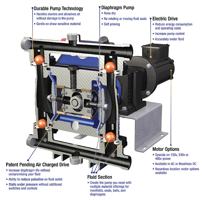

For years the only way to power a double diaphragm pump has been with pneumatic pressure to the pump, which can be limiting in some circumstances. For example, air capacity in a facility could be taxed by all other processes, air could be unavailable at a location or facilities could be looking to capitalize on the lower operations cost of electric. Fortunately, it is now possible to use the double diaphragm pump technology for chemical pumping without the requirement of large air compressors to power the pump. New electric diaphragm pumps remove the worry of worker and plant safety that other pumps have. The double diaphragm style pump is the same sealless design that is used on the air driven model discussed earlier, but electric pumps are not driven by compressed air. This means in the event of a diaphragm failure, the chemical will not enter an air motor and will not be pumped out the exhaust as previously discussed.
