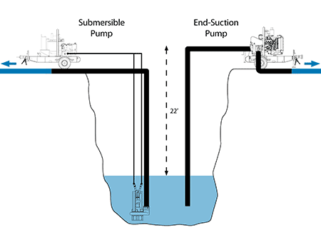

Once suction lift approaches or exceeds 22 feet, standard end suction pumps often face limitations. At this threshold, alternative technologies like hydraulic submersible pumps are worth considering.
Understanding Suction Lift
Suction lift measures how far a pump must “pull” water vertically into its intake. At sea level, atmospheric pressure theoretically allows a maximum lift of about 33 feet. However, real-world conditions—friction loss, air leaks, elevation and water temperature—reduce this practical limit to about 20-25 feet.

End suction pumps are workhorses in construction, agriculture, dewatering and industrial operations. They are relatively simple to maintain, cost-effective and widely available, but they have a built-in constraint: They rely on vacuum pressure to draw water upward through an airtight suction line.
- At a 22-foot lift, this process can become increasingly unreliable:
- Even minor air leaks or pinhole gaps in fittings can prevent priming.
- Friction losses in the suction line reduce lift capacity further.
- The pump operates near its limit, increasing wear and risk of failure.
Running an end suction pump under such stress can result in frequent downtime, overheating and elevated operating costs, making it a potentially poor fit for high-lift environments.
Benefits of Hydraulic Submersible Pumps

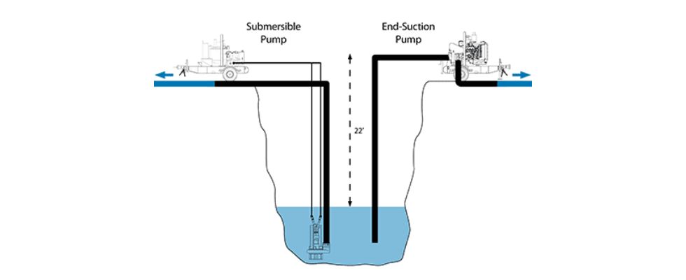

Hydraulic submersible pumps take a fundamentally different approach: They push water instead of pulling it.
These systems place the pump directly in the water source, eliminating the suction lift entirely. The pump is powered by a remote hydraulic power unit located safely above the waterline.
With no suction line, priming is not required. The pump uses the surrounding atmospheric pressure to maintain consistent, efficient flow, even in deep or fluctuating water conditions. This makes hydraulic submersibles a good option for:
