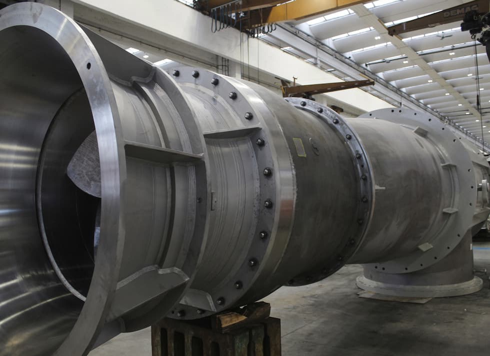

IMAGE 1: Vertical turbine pump for water intake service at desalination plant (Images courtesy of Trillium Flow Technologies)
