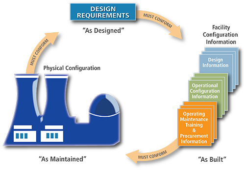

Figure 1. Configuration management method
Establishing a configuration equilibrium between the design requirements, the physical configuration and the supporting configuration (see Figure 1) became the key to meeting regulatory requirements and maintaining a safe working environment. This established CM as a key method at the heart of operational processes within nuclear facilities. Creating this equilibrium in retrospect was not an easy fix, but nuclear facilities have seen dramatic benefits through process improvements that have improved efficiency and safety.
