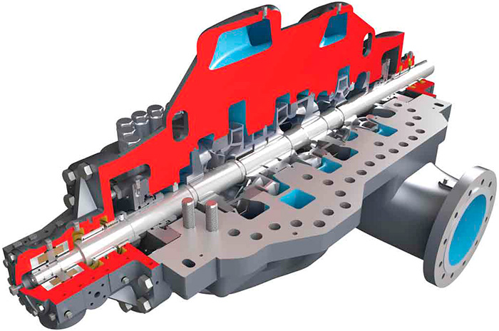

Figure 1. The Larnaca plant’s new installation uses a high-pressure membrane feed pump. The redesign reduces crossover losses by 40 percent. (Graphic and image courtesy of Flowserve) Building on Success

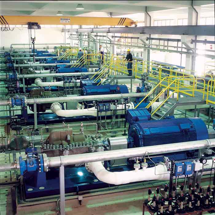

Image 1. High-pressure membrane feed pumps with energy-recovery turbines were used in the original installation.HP Pump Efficiency
To meet the new HP pump capacity and head requirements, the end user selected an axially split, three-stage centrifugal pump. With a redesigned continuous crossover that extends more than 180 degrees, the selected pump is designed to reduce crossover losses by 40 percent. “The pump achieved a best efficiency point of 87.5 percent when installed,” Long said. Ringless impellers, Stellite-overlaid stationary rings and impeller hub, and channel rings with 360-degree guide vanes also contribute to greater pump efficiency, improved reliability and less maintenance.ERS Efficiency
