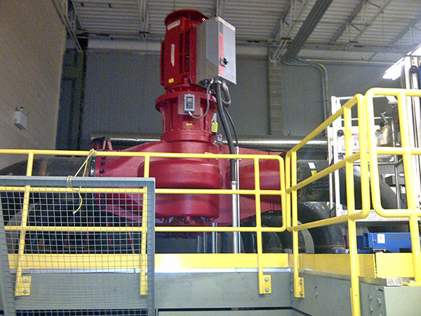

To meet the specific flow and head requirements of the project, the pump manufacturer for the project designed a new size of vertical in-line pump (VIL). Because the DLWC concept was new at the time, design engineers could not foresee the actual operating conditions of the pumps. It later became apparent that the system flow requirement was forcing the pumps to operate at a duty point that was substantially different from the originally specified performance curve.
Responding to the customer’s request, the manufacturer redesigned the pump impellers for higher pressure, lower flow operation. The redesigned 16 x 16 x 15 VIL pumps with 350-horsepower motors provided a high flow rate (10,000 gallons per minute) at low head (86 feet). With that correction in place, the pumps have operated flawlessly since 1992 with few maintenance requirements.

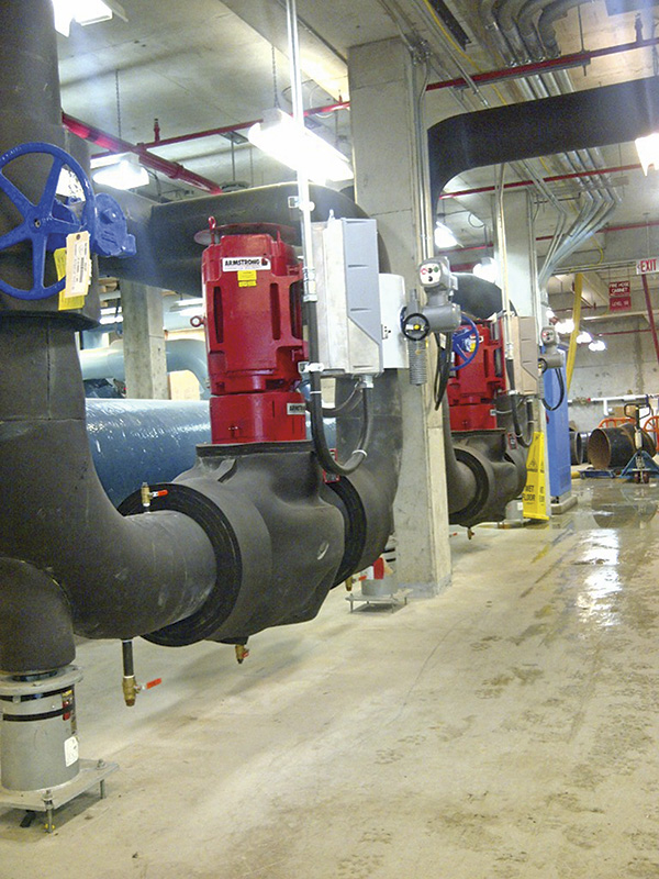

Recently, the cooling facility was upgraded to include a new 8,000-ton cooling plant. The organization needed to complete the project quickly. That, among other factors, led to a decision to use VIL pumps with integrated controllers and design envelope technology, which includes a pre-set performance curve and control algorithms that automatically adjust motor speed so the pumps operate at their most efficient levels. Project managers chose a pump manufacturer that would test the pumps thoroughly—including the integrated controllers—before delivery, knowing that this factory testing would condense the schedule for delivery and installation.
Using intelligent variable speed control instead of constant speed allowed designers to avoid the inclusion of balancing valves and allowed operators to control the flow through digital means rather than mechanical. This also made commissioning the new system easy, so that the entire balancing process took only one hour.
A number of factors contributed to the decision to install VIL pumps. From a mechanical standpoint, project managers and contractors appreciated the fact that VIL pumps use a balanced impeller and include no thrust bearings. This makes the pump much easier to work with because it has no flexible coupling and no issues with alignment at the installation stage or throughout its operating life.
The installation of the design envelope VIL pumps was plug and play. Contractors were brought onsite to connect the power to the controllers. Integration with the existing building management system using the BACnet protocol was completed easily.
The entire installation process required fewer trades onsite, and the system operators appreciated the single point of responsibility that accompanies an integrated pumping solution, rather than a controller and pumps from separate vendors. The instant feedback available through the integrated controller allowed the operators to find the best operating points easily, so that the pumps may be staged on or off at appropriate load levels.
In approximately 10 months of operation since the new pumps were installed, no major issues have arisen, and the operators are extremely pleased with the pump efficiency levels and the energy savings derived from using the design envelope technology.
The design envelope technology that is the foundation of these integrated pumps allows operators to dial back the pump speed to only 5 psi per pump during the winter months, when demand for cooling is much lower.
This means that the 600-horsepower motors operate at only 70 horsepower, saving the organization a tremendous amount of energy and related costs. In addition, as the load changes throughout the year and as different operators are tasked with managing the mechanical room, staff members spend less time adjusting and rebalancing the system. With established operating parameters documented and stored in the integrated controllers, any required adjustments can be made easily.
