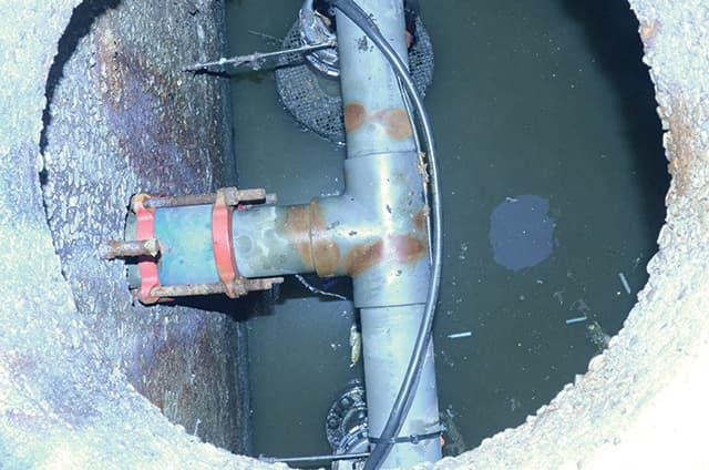

Image 4. The new pump was placed in the sump without a screen, alongside a shredder pump. Image 4. The new pump was placed in the sump without a screen, alongside a shredder pump.

One important advantage of the new system was immediately noticeable. Most non-clogs, including the second wastewater sump on the FoxRock property, must be surrounded by a screen. The solids and debris that get caught in that screen must be routinely cleared by hand. The installed pump does not require a screen. A post-installation inspection showed no debris in the sump.
"So far, I am very happy with the pump. It was installed in July 2014 and continues to operate without clogging," Snyder said.
