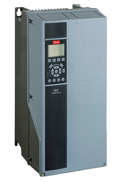

The VFD brings the blower up to speed by ramping the voltage. The newly installed VFDs can also be programmed to receive a signal from the dissolved oxygen sensor and adjust the blower speed accordingly.

“This application requires constant torque (CT). In CT applications, torque is directly related to current. That means a VFD maintains CT by increasing the voltage in a linear manner as speed increases.”
The VFD slowly ramps the voltage to bring the blower up to speed. The newly added VFDs can be programmed to receive a signal from the dissolved oxygen (DO) sensor and adjust the blower speed accordingly.
“The great thing about a positive displacement blower, as soon as the rotor turns, it is pushing air into the process,” said Kluver. “This creates an almost perfect linear performance curve. The higher the voltage, the faster the rotor speed, and the greater the airflow. On the other hand, if we only need half the air, we can reduce the blower speed and the horsepower by 50 percent and cut the kilowatts in half.”
Kluver contacted an equipment supplier near St. Paul with a VFD specification, and the supplier recommended a VFD that was dedicated to water and wastewater applications. This allowed for simplified implementation. The VFD had many built-in features—including a cascade controller to radio frequency interface filter to input the choke to real-time clock.
On this plant’s basic positive-displacement blower project, the equipment supplier and Kluver took advantage of the built-in water/wastewater intelligence. They were able to input the DO value into the on-board, closed-loop control of the drive. The VFD display then showed the actual DO value, DO set point, motor speed and kilowatt consumption. As a result, an integrator was not needed, which helped with cost savings.
“Another cool feature is the VFD’s payback time,” added Kluver. “We entered the price of electricity, which is about seven cents per kilowatt hour, the equipment investment, and the load profile for the application. The VFD comes with software that continuously calculates the remaining payback time right on the display. It’s a great way to show how energy savings add up and when the investment is paid back.”
Kluver also appreciated that, when considering the implementation, a VFD was lent as a loaner.
“The supplier was really easy to work with. The loaner let us verify that the drive would work with our blowers and that we could get the energy efficiency we were hoping for,” said Kluver.
The drives are enclosed in National Electrical Manufacturers Association/Underwriters Laboratories (NEMA/UL) Type 1 cabinets in the blower room. No special ventilation was required or used. The VFD was able to handle high temperatures well. It is rated up to 50 C (122 F), because of a heatsink built into the chassis.
