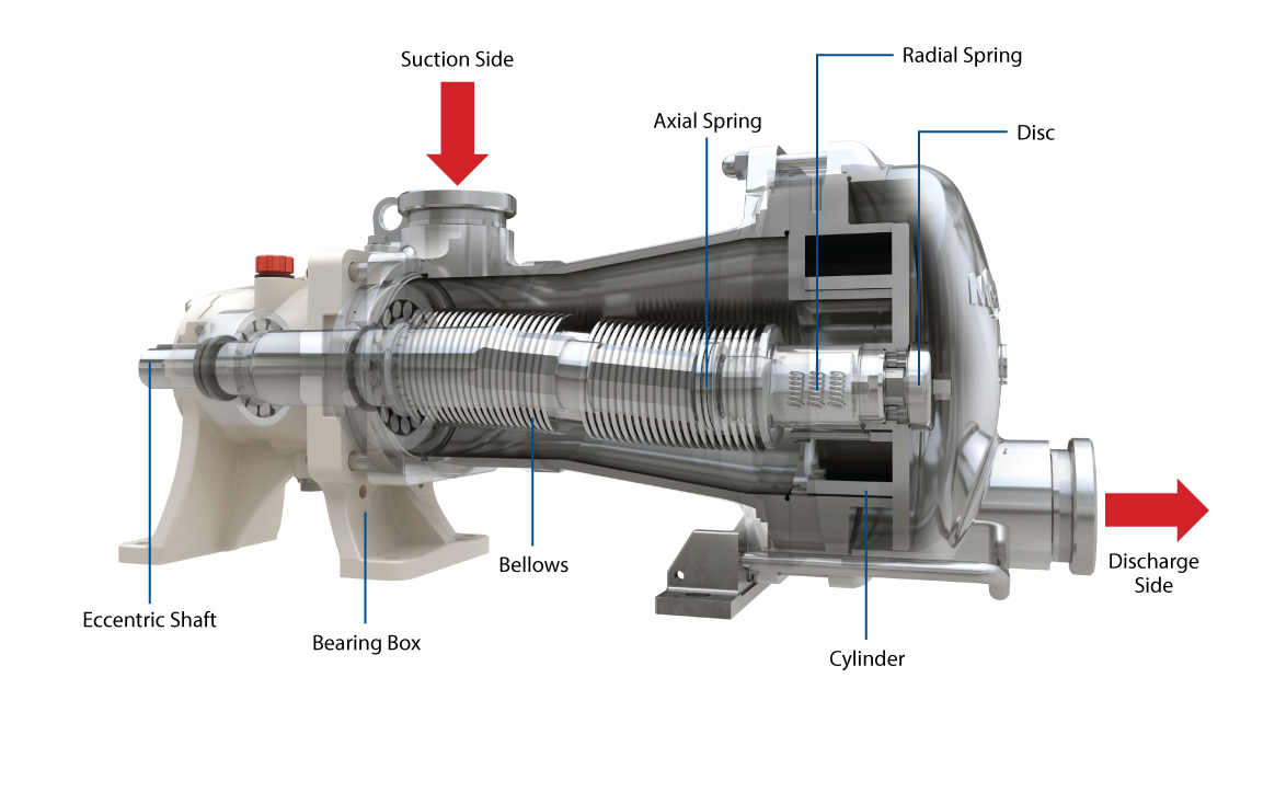

Eccentric disc pumps consist of a pumping element mounted on an eccentric shaft inside a cylindrical chamber. As the shaft rotates, the disc moves in a circular motion, forming progressively expanding and contracting chambers. This action enables precise fluid displacement, drawing the product into the pump at the intake port and gently pushing it out through the discharge port.
This method ensures a pulse-free, constant flow, which is crucial for processes requiring accuracy in dosing, metering and blending. Additionally, instead of relying on high speeds to generate flow, eccentric disc pumps can maintain their performance across a wide range of viscosities and pressures without compromising efficiency.
An added advantage is the availability of sealless models, which eliminate potential leakage points and enhance sanitary compliance—an essential factor in food and beverage processing.

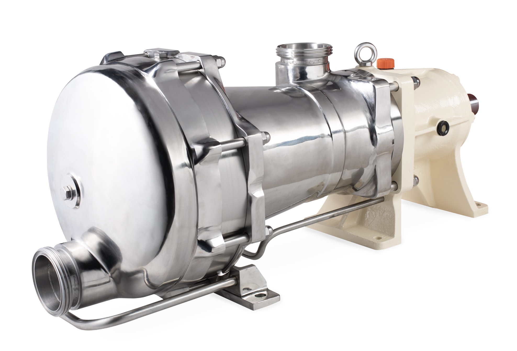

![IMAGE 2: Eccentric disc food grade transfer pump for hygienic applications requiring high flow rates (up to 70 cubic meters per hour [m3/h] (300 gallons per minute [gpm]), 10 bar (145 pounds per square inch [psi]).](/sites/default/files/15353/Mouvex_1025_IMG2.jpg)

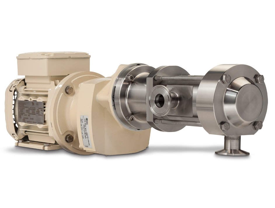

![IMAGE 3: Eccentric disc pump for continuous dosing with low flow rate (below 800 liters per hour [l/h] [3.5 gpm])](/sites/default/files/15353/Mouvex%20Micro%20C%20Series.png)

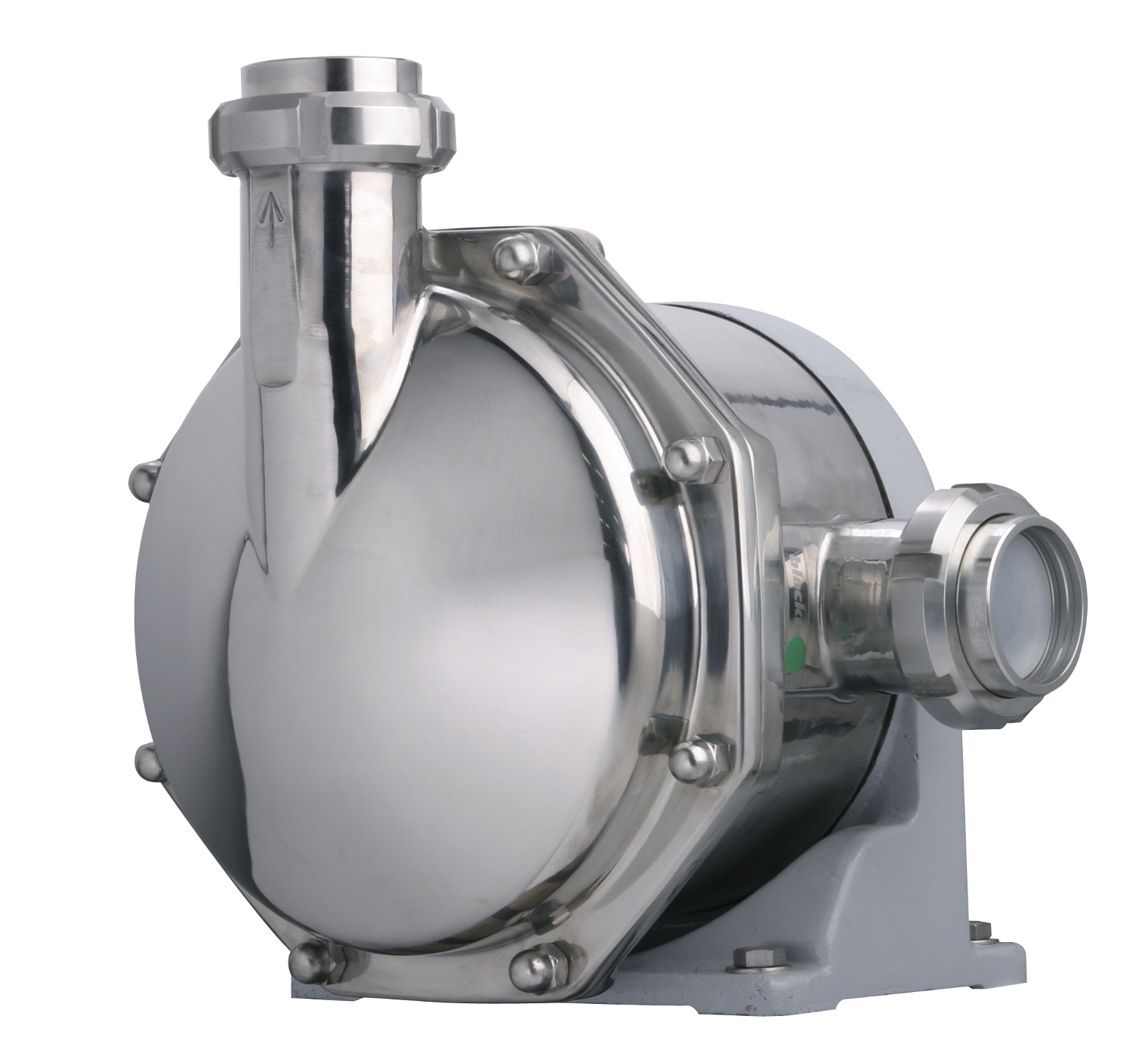

![IMAGE 4: Eccentric disc pump for sanitary applications with COP, requiring quick and easy dismantling (up to 12 m3/h [52 gpm])](/sites/default/files/15353/Mouvex_1025_IMG4.jpg)
