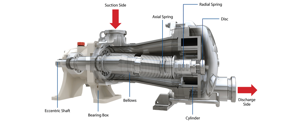

Eccentric disc pumps consist of a pumping element mounted on an eccentric shaft inside a cylindrical chamber. As the shaft rotates, the disc moves in a circular motion, forming progressively expanding and contracting chambers. This action enables precise fluid displacement, drawing the product into the pump at the intake port and gently pushing it out through the discharge port.
This method ensures a pulse-free, constant flow, which is crucial for processes requiring accuracy in dosing, metering and blending. Additionally, unlike centrifugal pumps—which rely on high speeds to generate flow—eccentric disc pumps maintain their performance across a wide range of viscosities and pressures without compromising efficiency.
IMAGE 1: Parts of an eccentric disc pump (Images courtesy of Mouvex)

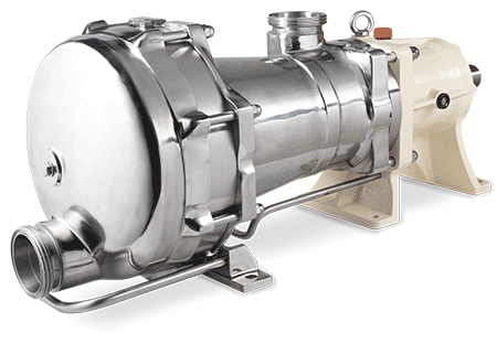

IMAGE 2: Eccentric disc food grade transfer pump for hygienic applications requiring high flow rates
