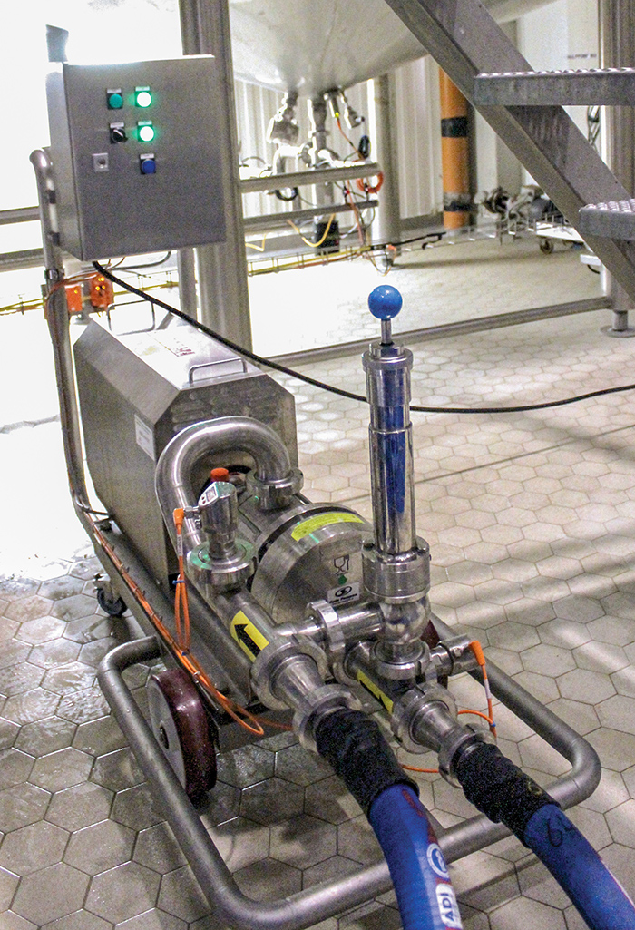

Manufacturers of food and beverages, pharmaceuticals or cosmetics use components and make products that are among the most expensive in the world. Significant and immediate cost savings can be achieved by improving the volume of premium end-products and costly materials that are recovered from transfer lines. Given the value at hand, any potential for increased retention and recovery is worthy of exploration. Product waste is always the enemy of profitability, and even more so when the products have high cost. More than $120 billion of product goes to waste worldwide every year, according to the McKinsey Quarterly Food Waste Alliance. The Natural Resources Defense Council (NRDC) has also studied the issue and found that 40 percent of food in the United States is lost during handling and production.
![hygienic manufacturing](/sites/default/files/1017/Mouvex_Coca-Cola_6-copy.jpg)
- increased water use for cleaning the lines
- additional cleaning and treatment chemicals to clean the lines
- chemicals to sanitize the lines
- energy to facilitate the cleaning process
- labor costs/hours to perform longer cleaning operations
- disposal costs of used water, chemicals and product
- water treatment costs and associated chemicals

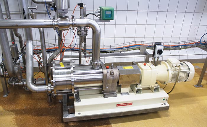

Design Advantage
Strong product recovery is possible with eccentric disc pumps because of their unique design. Each pump employs a disc that moves on an eccentric plane within a circular channel, creating the capability for non-pulsing, low-slip operation with high volumetric consistency. The operation of eccentric disc pumps allows flow rates to vary minimally despite changes in viscosity, temperature, system back-pressure and even component wear. Eccentric disc pumps can operate with such high efficiency that they can pump air when no fluid is present, which creates a vacuum effect on the suction side and a compressor effect on the discharge side of the pump. Once the product runs out in the feed tank, the eccentric disc technology continues to pump air in a very constant, non-abrupt, non-pulsating manner, so that the surface tension on any remaining fluid is not broken. This produces a plug effect, which pushes out the product “plug” as a whole.![eccentric disc pumps](/sites/default/files/1017/Mouvex_Ysco4-copy.jpg)
- The pumps can recover product from tank bottoms as well as inlet and outlet lines.
- They can recover product from small lines where pigging is not possible.
- They can recover product through a line outfitted with ordinary valves, heat exchangers, magnetic traps, flow meters and other accessories.
- Product recovery is seamless, as no line interruptions will occur between normal production and the product-recovery phase.
- For the majority of the process, air mixing is not a concern, as most of the product recovered by an eccentric disc pump comes in the form of a product plug with no air mixed in. A simple flow switch can be used to shut down the pump before the air purge reaches the product’s destination.
