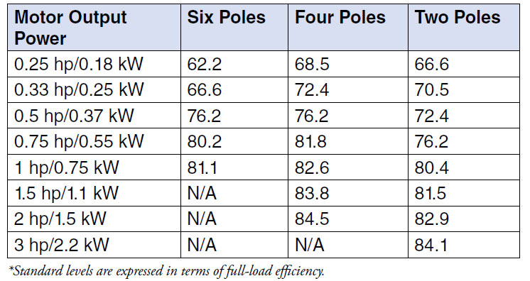

For the first time, the United States Department of Energy (DOE) adopted energy conservation standards for small electric motors in February 2010. DOE determined these standards will result in significant conservation of energy, and are technologically feasible and economically justified. Motors covered under these new regulations range from ¼ to 3 hp and include single and poly phase two, four and six pole general purpose motors in NEMA 42, 48 and 56 frames and corresponding IEC equivalent motors and frames. The new regulations will take effect in 2015, which is five years after the original publish date.
Tables 1 and 2 show these new minimum efficiency standard levels, which apply to all small electric motors manufactured for sale in the United States, or imported into the U.S. either as standalone items or as a part of a system.
Table 1. Standard levels for polyphase small electric motor
Table 2. Standard levels for capacitor-start induction-run and capacitor-start capacitor-run small electric motors
