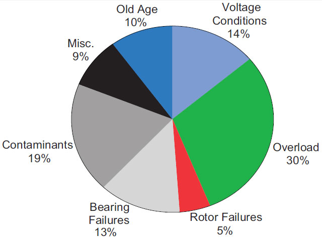

Graph

What data will help reduce troubleshooting time? Figure 1 from Cooper Bussmann reflects the causes of motor failures. This chart indicates that voltage conditions and overloads (which are related to torque) cause 44 percent of failures. The chart also shows that rotor failures, bearing failures, contaminants and some miscellaneous failures can impact torque. Pump failures can also create shaft, bearing, contaminant and other failures that impact torque. Torque changes will be reflected in current or power draw. Monitoring power, current and if possible power can detect 81 to 90 percent of motor failures, and some pump failures.
