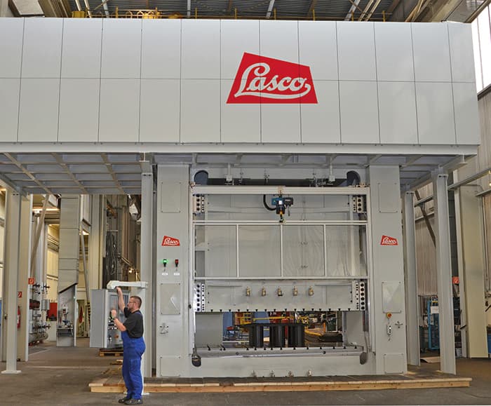

The company has a strong focus on continuous improvement in its processes and technology. The servo technology is a technological milestone, as demonstrated through Lasco’s implementation in a recently delivered deep drawing press with a press force of 800 tons for up to 40 strokes per minute.
The servo-electric pump control for presses, developed by Lasco Umformtechnik GmbH in Coburg, uses far less energy than conventional valve control systems, often well into the double-digit range, according to this press builder.
