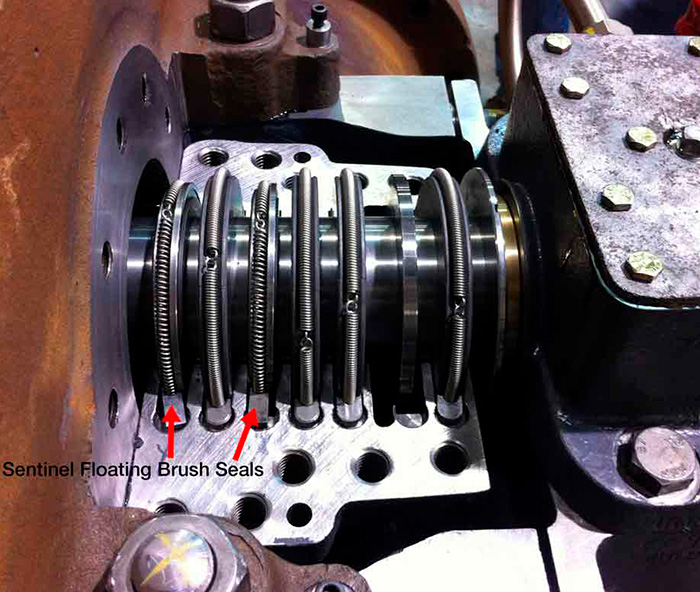

The second candidate for replacing carbon rings is a floating brush seal (FBS). An FBS combines a carbon seal with brush seal technology encased in a lightweight stainless steel band. This technology is designed to withstand condensate flashing while providing a lower, more stable leakage rate.
As a floating seal, the FBS tends to be more tolerant of vibration, bearing failures and radial movement than other options. The brush seal acts as the primary shaft seal and faces the high-pressure steam. It provides immediate pressure reduction while its bristles filter out steam contaminants, protecting downstream carbon rings. The carbon ring of the FBS provides a face seal against the downstream gland wall or separator plate.
Designed to fit the same space as a carbon ring, an FBS can be a drop-in replacement. The seal has a split design, with two segments held together by a garter spring. Its self-centering assembly may eliminate the need for an involved alignment procedure in some applications.
Operators trained in the replacement of carbon rings can replace a carbon ring with an FBS, which has only two segments versus the carbon ring’s three.
With a complete steam turbine upgrade to FBS technology costing no more than half—and maybe even one-quarter—of the cost of mechanical seal hardware and installation, an FBS may be a more cost-effective option for many operators.
