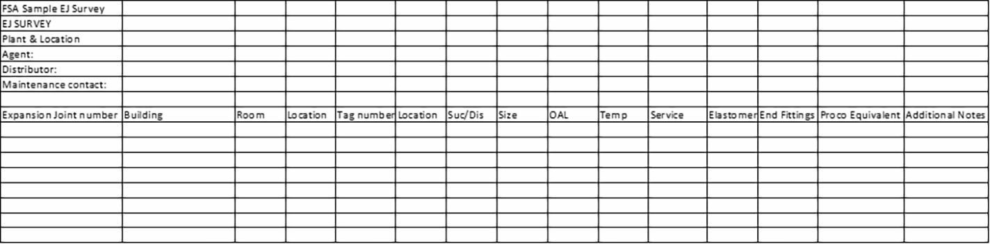

Using new lists of expansion joints to create a history of life expectancy.
Each time an expansion joint fails at a given location, it can be noted on the store’s list. This history will help prepare for ordering replacements in a timely manner before the anticipated failure.
Sample Spread Sheet
IMAGE 5: A sample expansion joint survey spreadsheet
Being proactive as opposed to reactive.
