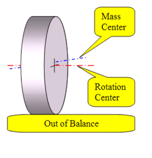

One common definition of balance is when the mass centerline and the rotational centerline of a rotating part are equal. Another definition is when zero vibratory force or vibratory motion is imparted from the rotating part to the bearings. Field balancing is a technique used to balance a rotating part in place without removing the part from the machine. The advantages of field balancing are apparent, in that time can be saved by not removing the rotating part from the machine and sending it to a shop for balancing. An additional benefit is realized in ensuring that the rotating part is balanced as installed.

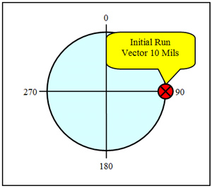

Balancing in its most basic form is a problem of ratios. To simplify, we will use a one plane example and eliminate the angle calculations by assuming we know exactly where the heavy spot is located on a rotor. Figure 2 depicts an end view of a rotor. The amount of vibration is measured and indicates 10-mil of vibration 90-deg from the 0 angle reference. No weight has been added at this point and the measurement represents the “as found” condition.

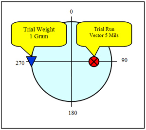

Figure 3 depicts the trial weight run. Trial weights provide a method to calibrate the rotor system. A known trial weight, placed in a known position, will influence the vibration a specific amount that will permit correcting the measured imbalance.
Figure 3
In this example, we have placed one gram of weight at 270-deg. The resulting vibration was reduced from 10-mil to 5-mil and the angle did not change. This means we placed the trial weight exactly opposite the heavy spot on the rotor.
Now we can apply the ratio:

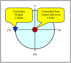

Figure 4 shows the correction and result. As can be seen from the ratio, if one gram reduced the vibration from 10-mil to 5-mil, then two grams placed at the same location should reduce the vibration to 0-mil.
