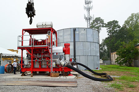

IMAGE 1: Test stand -1,000-hp diesel-driven offshore fire water pumps for a deep-water oil production platform.

Run Dry Conditions
Since the pumps are on standby for extended periods of time, the upper bearings are usually dry. During startup, it takes a considerable amount of time for the seawater to travel up the 175-foot shaft to lubricate the bearings. Thus, the bearings experience extended “run dry” conditions—every time the pump starts, the bearings have to operate without sufficient lubrication. Traditional bearing materials require constant lubrication or they can wear excessively, leading to failure and possibly seizing the pump. This can compromise the firefighting system, a dangerous situation.
Graphite-metal alloy bearings can handle these conditions, due to their non-galling and self-lubricating qualities. The graphite structure acts as a deck of cards, providing layer upon layer of lubrication, while the metal adds strength and wear resistance. This allows pumps to continue operating during system upsets or extended periods of running dry, without seizing.
