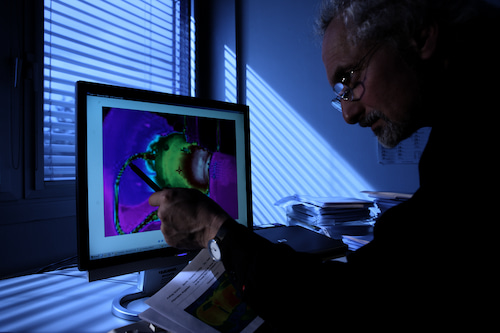

New computer programs allow seals to be modeled and prototyped prior to manufacturing to confirm how they will handle specific operating conditions before being installed in the field. Seal manufacturing design capabilities and the technology of seal face materials has progressed to the point that they can be developed for a one-to-one fit for a process application.
Today’s computer modeling programs and technology allow the use of 3-D design review, finite element analysis (FEA), computational fluid dynamics (CFD), rigid body analysis and thermal imaging diagnostic programs that were not readily available in the past or were too costly for frequent use with earlier 2-D drafting. These advancements in modeling techniques have added to the design reliability of mechanical seals.
