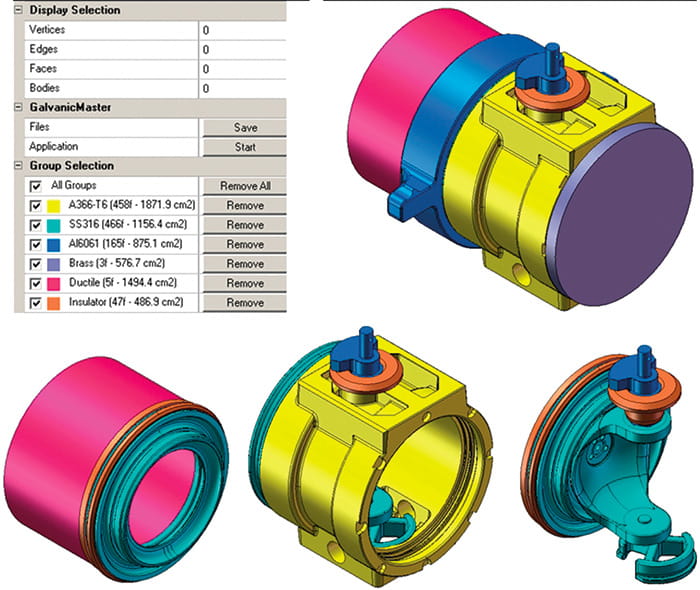

CAD-Import
In the first step, a 3-D, CAD model is loaded in the software. The user selects the different components and defines the materials. Each material group has its own color to keep a clear overview, and the total surface area for each group is listed as a reference. In this case, the assembly contains five metals (including iron and brass) and several insulating gaskets.Defining the Boundary Conditions
