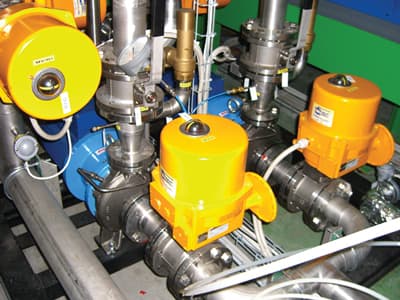

.jpg)
Centrifugal mag-drive atomic particle accelerator cooling pumps.
A highly engineered seal-less pump design has significant benefits over mechanically sealed counterparts in radioactive applications. Longevity, breach resistance and rapid maintenance procedures within "hot zone" areas are vitally important. Heavy duty, mag-drive containment shells have withstood rigorous destructive testing without leakage.
Ten-minute overall requirements are met with quick-change cartridge assemblies and registered fits. Additionally, rugged alloy mag-drive pump designs, free of fluoroplastic coatings or linings, are preferred in radioactive liquids for long-term reliability, without risk of material degradation from the penetrating power emitted by the nucleus of radioactive substances.
