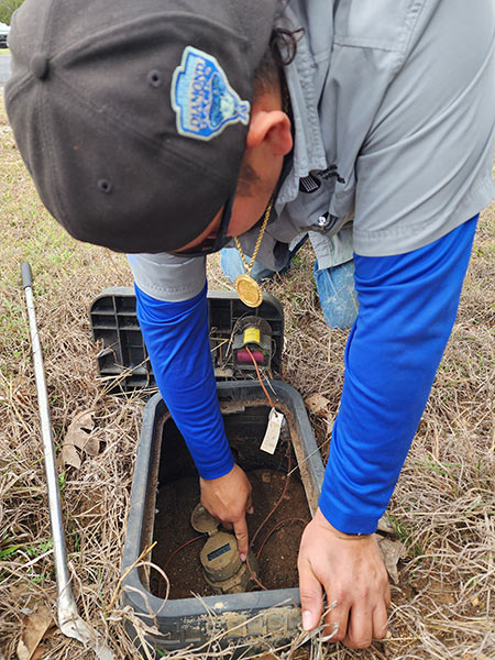

By leveraging smart water tools, Texas Water Utilities achieved improvements in efficiency, cost savings and sustainability across north Texas. While the utility initially relied on automatic meter reading (AMR) technology, this drive-by data collection system struggled in rugged and remote areas, leading to inconsistent readings and frequent missed signals. With AMR, water loss and nonrevenue water—water pumped but never billed—remained stubbornly high, draining both resources and revenue.
The transition to cellular advanced metering infrastructure (AMI) marked a turning point for the utility. AMI uses cellular connectivity to transmit real-time data, eliminating the need for drive-by readings. With continuous, accurate data collection and remote monitoring of water flow and pressure levels, the utility could now identify high flows and potential leaks before they became costly issues.
The benefits were immediate. In one rocky, cliffside community, the utility reduced nonrevenue water from 92% to 38%. Despite the potential for water loss when pumping hundreds of thousands of gallons in a day, AMI allowed the utility to pinpoint sources of leakage that would have been nearly impossible to detect through traditional means, enabling them to make repairs and save precious water resources.
Recently, the utility integrated additional leak detection and pressure monitoring devices—custom fit and deployed for these applications—that provide enhanced pressure monitoring and visualization tools, allowing for quick identification and resolution of potential issues. Trend reporting and alarms help workers interpret data easily. Data visualizations also allow workers to communicate performance metrics and improvements to community stakeholders, helping them understand the benefits of the investment in real terms.
IMAGE 1: A cellular AMI system helps Texas Water Utilities receive precise flow monitoring data. (Image courtesy of Badger Meter)
