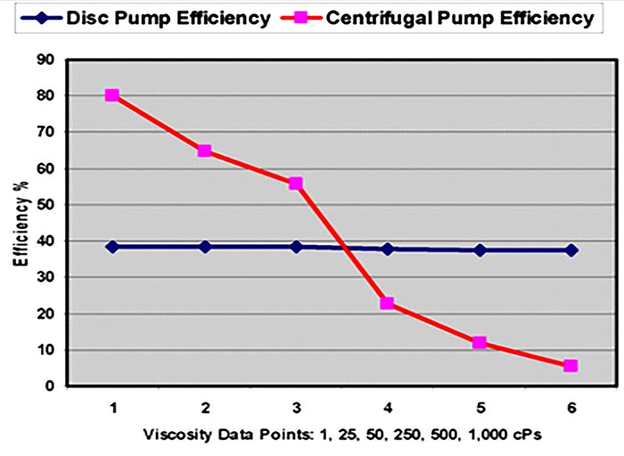

The efficiency of the disc pump actually increases with viscosity. This is illustrated in Image 2. The practical limit for the conventional centrifugal pump is 250-300 centipoise (cP). The disc pump maintains a near constant efficiency from that 300 cP limit to 10,000 cP viscosity and even higher. The disc pump is also capable of passing large, rock-hard, abrasive solids. Consider dewatering applications such as in filter press feed. The pump is required to begin the cycle at a high flow and relatively low head. As the press fills, flow falls and pressure increases. The end cycle is at high pressure and near shut-off head.
image 2 disc pump efficiencyImage 2. Disc pump efficiency vs. centrifugal pump efficiency
The ability to handle the extreme range in viscosity (< 1 to 10,000 cP) with a standard design pump is most advantageous, particularly in a process that starts with water-like viscosity and increases to 1,500 cP or higher. While relatively low with water (compared to a centrifugal pump designed for water), efficiency is maintained with increasing viscosity to 10,000 cP and higher (see Image 2). The large internal tolerances are advantageous in pumping materials that tend to deposit out on internal surfaces such as lime slurry.
