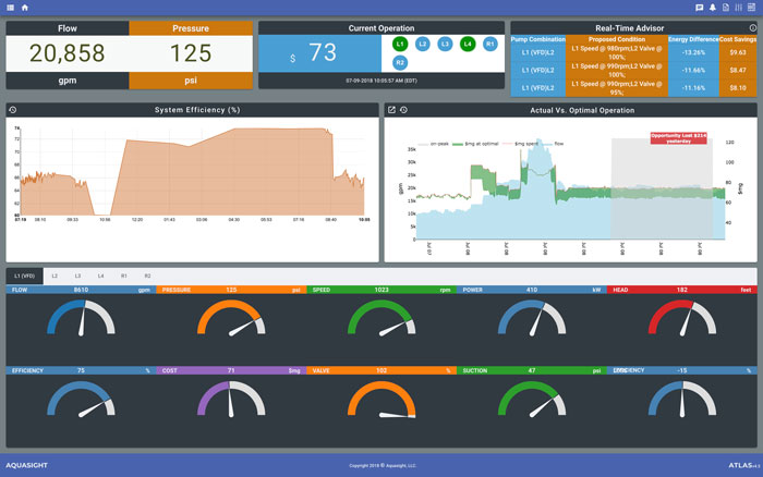

A real-time AI platform was deployed to manage the health and efficiency of the station. The platform featured a dashboard with a built-in AI advisor that displayed pump station performance and issued real-time advice on the most efficient operation based on live, on-the-ground conditions, equipment performance and availability (see Image 1). Based on the real-time advice, the operator saw an annual energy savings of 15.4 percent.

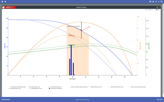

In addition, the platform has built-in motor and digital pump health check capability (see Image 2). It visually displays where a pump is operating on its pump curve and creates a new curve that may be different than the original factory curve. This was found to be very useful to trigger maintenance that is based on real-time asset intelligence rather than a fixed preventive maintenance schedule. At this station, three out of six pumps were operating off their curve either due to degradation or system design, resulting in an additional $72,000 per year of operating costs.
