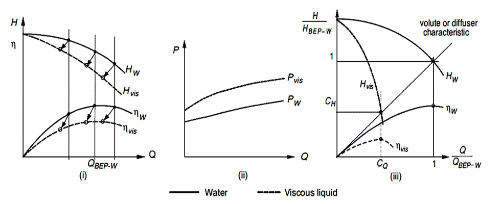

How head, efficiency and power characteristics typically change from operation with water to pumping a highly viscous liquid
IMAGE 1: How head, efficiency and power characteristics typically change from operation with water to pumping a highly viscous liquid (Image courtesy of Hydraulic Institute)
However, there will be friction losses that will offset volumetric efficiency gains. So, at a certain viscosity, the efficiency will decrease. In general, positive displacement pumps will be affected less by viscosity than rotodynamic pumps.
When a liquid of high viscosity is pumped by a rotodynamic pump, the performance is changed in comparison to performance with water, due to increased friction losses. The reduction in performance on viscous liquids may be estimated by applying correction factors for head, rate of flow and efficiency to the water performance as outlined in ANSI/HI 9.6.7 “Rotodynamic Pumps­—Guideline for Effects of Liquid Viscosity on Performance.”
equation 2As detailed in the standard, the curves for head and efficiency for viscous liquids (vis) are estimated from the head, flow and efficiency measured with water (W) by applying the correction factors CH, CQ and Cƞ, respectively (Equation 2).
