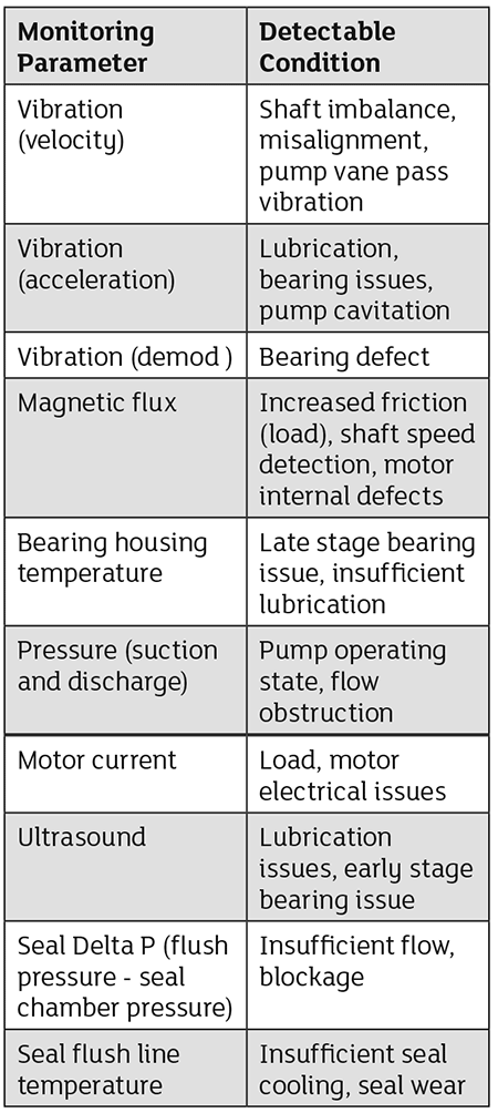

Finally, combining mechanical and process signals supports better root cause analysis and more targeted corrective action. This means smarter decisions on lubrication, load balancing and service intervals, leading to a more proactive, data-driven reliability program. Image 1 summarizes how different parameters help detect common pump failure modes.

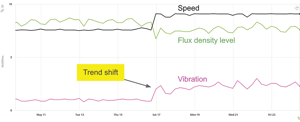

In this instance, a change in process demand caused one pump in a three-pump system to ramp up to full speed. As expected, the increase in speed resulted in a corresponding rise in vibration levels (Image 2). Without additional context, this could have prompted an unnecessary inspection.
By correlating vibration with speed and load information derived from magnetic flux, the monitoring team confirmed that the elevated vibration was consistent with normal operating behavior and not indicative of a developing fault. This helped avoid unneeded downtime and ensured maintenance attention remained focused on truly at-risk assets.
