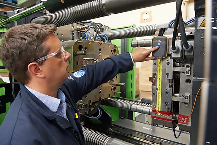

Image 1. Maintenance technicians can place portable sensors on operational equipment to monitor for up to a month. (Images courtesy of Fluke Corporation)Detecting Glitches
Some plants have at least one multimillion-dollar machine, also known as a tier one asset, that is powered by smaller equipment down the line. Often, these tier one machines are equipped with monitoring sensors by design, so plant managers can keep tabs on these machines’ performance. A step down leads to second tier assets, which are often worth many thousands of dollars and are process-critical. These assets rarely have fixed sensors, so plant operators are often in the dark when it comes to raw data. For example, if a circuit is tripping intermittently and shorting a motor, and the conditions revert to normal by the time a technician arrives at the panel to troubleshoot, there is not much to do other than wait for the next circuit trip. With portable condition monitoring sensors mounted on panels of this second tier equipment, managers and technicians can see intermittent faults as they happen or over time from their desktop, mobile phone or tablet. The equipment condition data allows “eyes” into what is going on with operating equipment, leading to better decision making on repairs, adjustments or replacement. Portable condition monitoring sensors, for example, can simultaneously measure all three legs of three-phase power. A technician can attach one current sensor to each phase or use the power monitor and then view the results on a smartphone. Since all three phases can be viewed simultaneously in real time, it is easy to quickly see differences between phases.
