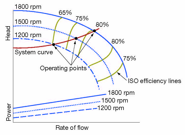

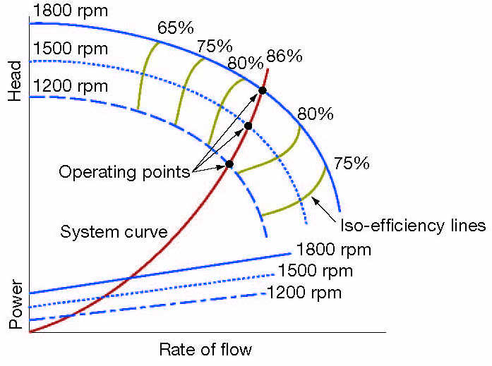

Q.  What are the effects of varying speed in pumping systems with predominant friction head and systems with high static head?
A.  To understand how speed variation changes the duty point, the pump and system curves are overlaid.  Note that the operating point always falls at the intersection of the pump curve and the system curve.  See Figure 4.15.  Two systems are considered in Figures 4.16 and 4.17, one with friction loss only and the other with static head high in relation to friction head.
In Figure 4.16, the effects of reducing speed in a friction-only system are shown. The pump duty curve intersection point on the system curve moves along a curve of nearly constant efficiency. The operating point of the pump, relative to its best efficiency point, remains nearly constant, and the pump continues to operate in its ideal region. This means that a substantial reduction in power absorbed accompanies the reduction in flow and head, making variable speed control an excellent method for systems in which friction loss predominates.
Figure 4.16 Example of a the effect of pump speed change in a system with only friction loss
In a system with static head, the system curve does not start from the origin but at some nonzero value on the y-axis, which corresponds to the static head. This is shown in Figure 4.17. The reduction in flow is no longer proportional to speed; a small turn down in speed could result in a large reduction in the rate of flow. In turn, this means that the pump efficiency changes when the speed of the pump changes. While the reduction in pump input power may still be significant, the benefit is diminished by a reduction in the pump efficiency.
Figure 4.17. Example of the effect of pump speed change in a system with high static head
In systems with high static head, selecting a pump with a system curve that intersects the full-speed pump curve slightly to the right of the best efficiency point (BEP) is often beneficial. In these cases, the pump efficiency will first increase with the flow demand and, as a result, the speed is reduced. As the flow continues to decrease, the efficiency is reduced. This can extend the useful range of variable speed operation in a system with static head. The pump manufacturer shall be consulted on the safe operating speed range for the pump, since reduced pump flow may adversely affect the hydraulic stability of the pump.
In a high static head system, variable speed drives may not yield an energy saving or economically justifiable benefit. Decreasing the speed too much can cause the flow to approach shutoff, and the energy input to the pump will result in the heating of the liquid through friction. Then extreme temperatures can quickly be reached, resulting in severe damage to the equipment. However, a variable speed drive may prove useful should the system require frequent controlled starts.
